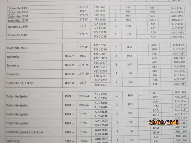

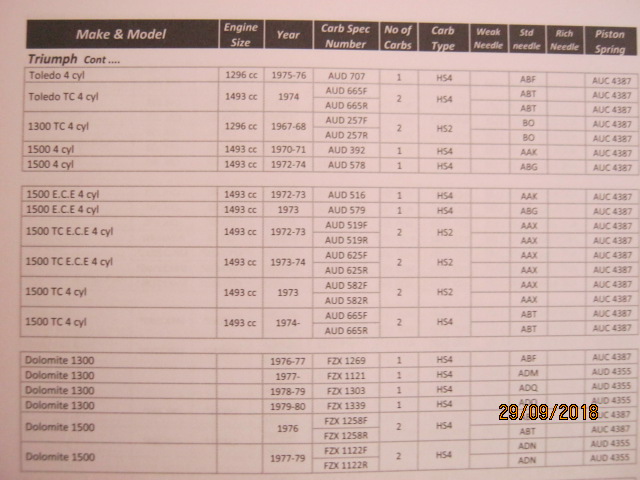

Std needle for an early 1300 is ADM. This may help? Or give somebody like canley classics or Burlen
http://www.teglerizer.com/cgi-bin/needle090db.cgi
http://www.teglerizer.com/suneedledb/09 ... tjava2.htm
so a similar needle but more profile/richer at the top end could be ADL (but that is just by looking at a needle that is richer , so doubtful it would be correct!) OR you could just take the dashpot/piston assembly out, take a fine file and take a flat off the needle from about 1/2 way down. And then drive it, see if better, try again etc. Would be much easier with a wideband AFR gauge!
