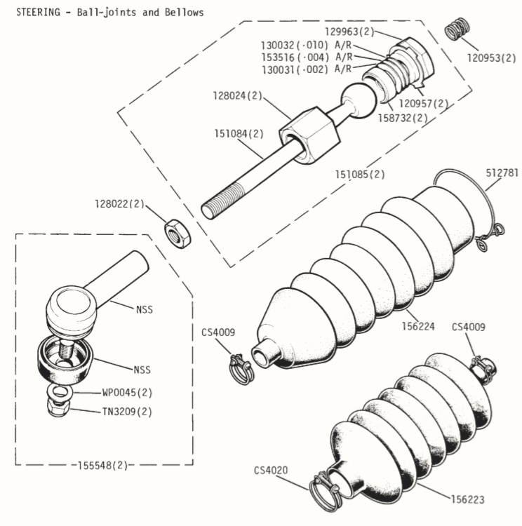

You talking about the track rod end perhaps? A common <£10 part easily found if you are.
Dolomite TRE.jpg (109 KiB) Viewed 895 times

The bit at the end, 155548 but if you don't recognize it from picture then it was probably something else!

wellskint wrote: Thu Oct 18, 2018 9:58 pm forgive my ignorance but which part is the track rod end?
On the picture above the inset section on the left is the track rod end, part number 155548. It's a ball joint so they do wear out and would cause some play in the steering, but the good news is that they're cheap and easy to replace. Here's an example from a good supplier, you can probably find them a couple of quid cheaper if your username is true. :D
http://www.angclassiccarparts.co.uk/hom ... 0hl-sprint
The next thing I'd look at would be the bushes that hold the steering rack onto the subframe, on the diagram below it's part number 139386. There is one on each end of the rack.
I'd say that given the description a worn bush there might cause play in the place they were finding it.

If it's the long rack boot that you are refering to, then it's not the track rod end, as others have suggested, but the track rod inner joint where the track rod attaches to the rack. I have never changed these on a Dolomite but I have done them on an E46 BMW.
