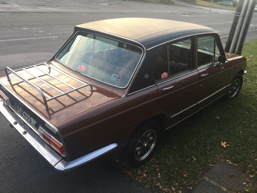

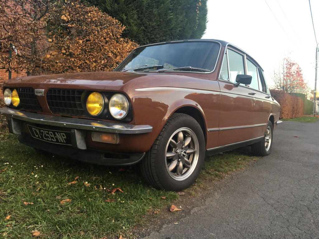

my dolly 1850 has a new sister in the garage :wink:
IMG_1266 (Copier).JPG (252.93 KiB) Viewed 6397 times
IMG_1265 (Copier).JPG (324.68 KiB) Viewed 6397 times

Looks good! Where did you find it?

one hour from my home , from an other enthusiast who wanted to find someone able to make all the work it needs
- engine needs rebuild
- gearbox a little bit noisy
-needs a kit of new bushes
-brakes need attention
a few hours to spend doing all these jobs :roll:

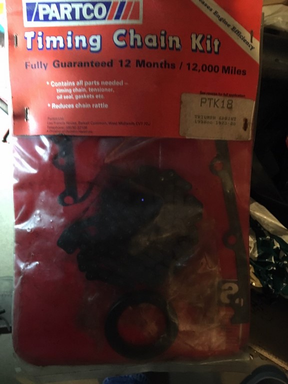

does anybody know if this is a good quality one ?
timing (Copier).jpg (73.7 KiB) Viewed 6141 times

It's a good old one and Unipart rebranded them ..... So a good chance it might be a genuine one :D I think the brand to avoid was "Rolon" Just check the tensioner.
