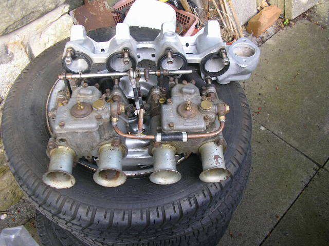

Oh well I have bought them now as I thought the price was a good one anyway.
This is how they look up against a manifold I bought on ebay a couple of years ago
I am in no rush to bolt them onto the car :wink:
Image [/img]

I suppose there are few things better than twin dual choke webers under the bonnet. 8)
