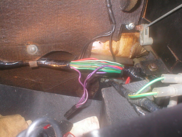

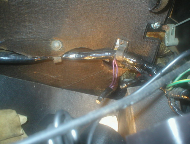

Now luckily this time the short circuit stayed on the output side of the fuse so I was able to determine it was on the Purple wire. But it disappeared again when I moved the loom under the glovebox and wouldn't come back. So it was out with the glove box again and a visual check. I had a better inspection lamp this time and I was able to determine it wasn't the clock wiring or the ciggy lighter, but where the loom is clipped to the rear of the bulkhead I could see 3 purple wires tightly compressed by the metal fixing clip. So I had the clip out ( the screw was well rusted in ) and I could see that this bit of the loom had been really compressed over the years just where the 3 purple wires leave the loom to join at the inline connector. But I couldn't see any sign of burning or bare copper. So for now I've separated out the purple wires, I shall get a plastic P-clip this weekend and separately tape up the purple wires, then the black wires and then the rest of the cables. I'm having to assume for now that I've had 2 separate faults.
I'm going to leave the 5A fuse in for now until I've got a bit more confidence. I'd be interested to hear if anybody else has this metal wiring clip just above the nearside parcel shelf. This may be a special SWK "thing" as it was the BL development car with and had extra boxes of electronics and wiring.
I have some photos this time.
- wiring clip1.JPG (89.46 KiB) Viewed 9264 times
- wiring untaped2.JPG (93.12 KiB) Viewed 9264 times

My September 1975 1850 cross-over model between Dolomite and 1850HL has (had) exactly the same clip but on the offside bulkhead, and the reason I know is the sidelights went awol with a smell of burning one evening. I actually traced it to aaarrggh, I can't remember exactly, a screw at the rear of the parcel shelf or similar cutting through the wires and shorting out, my fault. I can dig out the original post and photo's from the forum if required. But to repair the damaged wires involved pulling the metal clip from the bulkhead, and that wasn't easy! There's now a Nylon P-clip there!

Hi Bill, Thanks for that info; I detect these metal clips are quite bad news -40 years on ! I think I shall have a poke around on the offside as well next week. The problem is I don't think the sidelight circuit is fused; so this is why one may end up with burned wires.GTS290N wrote: ↑Thu Feb 07, 2019 9:35 pm Hi Tony,
Yes, Good Plan ! I think nylon P-clips are the way to go.
