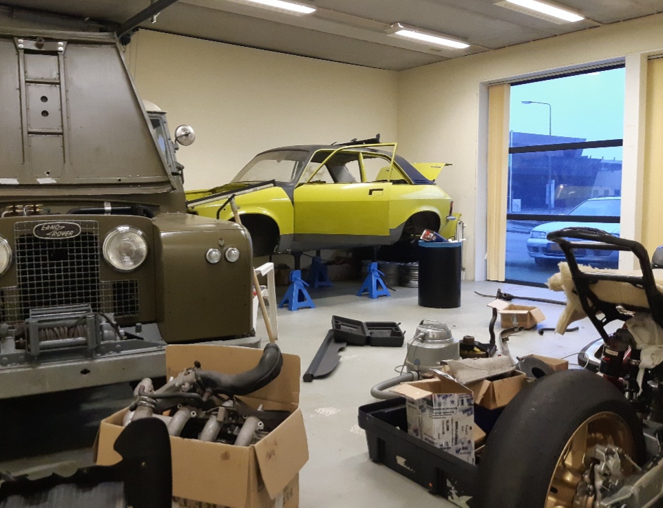

To lift up and occasionally work under the car I use four stands. I did think also about such a scissor lift as for wiring the dash is most of the time the highest point. Four stands gives more room under the car and easy to store. These stands can reach 80cm.
