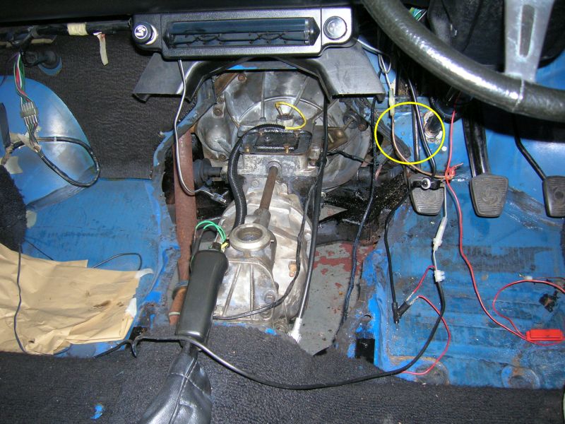

Since it is pouring at the moment, I have been to have a look at the driver's side footwell. The water is running down to the inboard side of the steering column. In my photo, taken during the rebuild, it seems to be getting in in the region of the yellow circle I have drawn. I don't think it is coming in around the steering column. Under the bonnet all this area is covered with the sound deadening material so its very hard to tell where it is getting through. Any thoughts?

Hate to say it but you might have a rust hole hidden behind the sound deadening. I have completely stripped my car and had to weld the bulkhead in multiple places. Most of these were small holes but more than enough to let in water.Bumpa wrote: ↑Tue Feb 05, 2019 4:50 pm Since it is pouring at the moment, I have been to have a look at the driver's side footwell. The water is running down to the inboard side of the steering column. In my photo, taken during the rebuild, it seems to be getting in in the region of the yellow circle I have drawn. I don't think it is coming in around the steering column. Under the bonnet all this area is covered with the sound deadening material so its very hard to tell where it is getting through. Any thoughts?

Carefully check where the pedals are situated. Having stripped mine to a shell I found a hairline crack in the bulkhead across this area. I understand that some strengthening is a good modification here.
