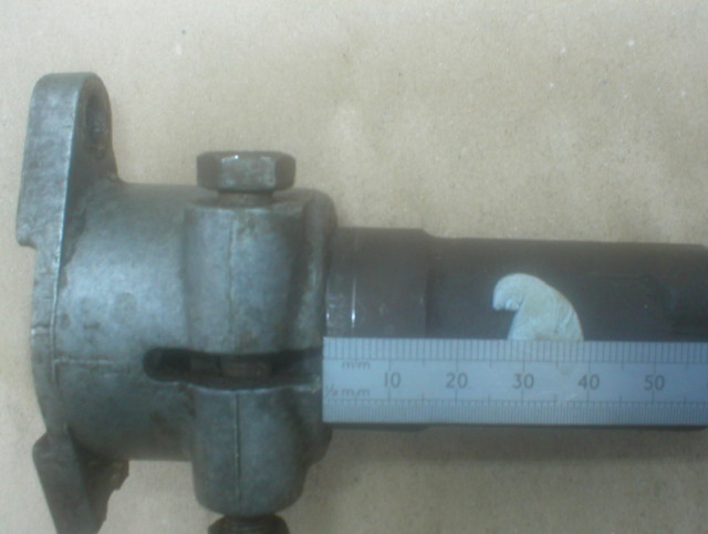

I don't actually have a 1500 Dolomite ( its an 1850 ) but I do have a 1500 bell-housing here with the clutch release mechanism I'm servicing for parts. Having got it apart and cleaned it , it looks as if there is scope for adjustment also at the slave cylinder, which may be masked by years of rust and gunge.
Now it is all cleaned, I can get good 4mm of forward - backward movement on the position of the slave cylinder in the ali; housing.
Now if the adjustment of the 1500 clutch is that critical, is it possible to get some extra offset by cleaning the cylinder / fixing bolt / bracket and setting the cylinder in the furthest forward position ?
Photo to illustrate herewith.
( Parts will eventually be on sale for Jonners fund btw )

I thought about increasing the length of the slot on the slave cylinder to allow it to be moved forward but it then protrudes out into the bell housing and I was afraid it would restrict the release lever movement.
