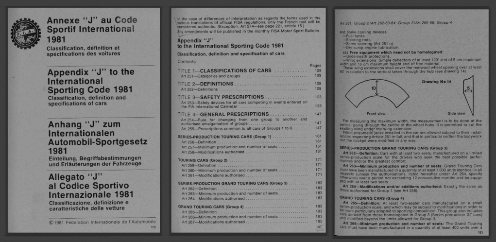

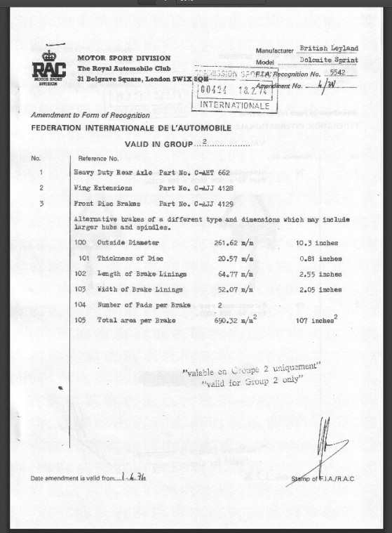

At first these are not homologated as in the FIA homologation form.
At second as Fia historic rally and race a Dolomite Sprint has to comply to the annex J of 1981. For gp2 the maximum with of the extensions can be 5cm max. and 10cm high max.
- extension.png (447.18 KiB) Viewed 10528 times
- homolo.png (330.42 KiB) Viewed 10528 times
