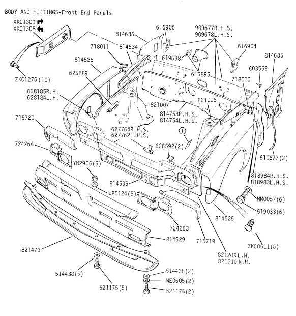

Hi Chris, Thanks for the link, that will be some help. I'm still at a loss, however, for how to mount to the car the flat plate with a step shown in the second picture in the linked thread and as 724263 in the attached file from the parts cat. I'm assuming that if it had been welded in place, the guy who fitted the wings and eyebrows, etc., would have welded it then.

Graham, part no 724263 which is the headlamp mounting panel should indeed be welded in place. Originally they were spot welded but I do know others on the forum have screwed/bolted them in situe but whilst I can see how this is done on the inner fixing point I am struggling as to how to do this on the outer point. As I am doing the same thing to mine at the moment(fitting headlamps) I will take a look this afternoon & see if something makes sense! I will take my camera with me and try to post a picture.

At the outer mounting, to the vertical face of the eyebrow, there should be a little right angle plate welded to the eyebrow to attach the headlamp support panel to. This is just visible in one of James' pics. Then there is a centre support bracket which is just visible (though not clear) on your exploded parts diagram it's on the inner front panel just inboard of the outer headlamp holes. This bracket is NOT sold separately (yet, i'm trying to persuade Alun to take it up with our fabricator as I need a couple!) and is nearly always chopped on removal. as is the bracket on the eyebrow. Actually it's not too hard to fabricate either and i'm just being lazy. Note, if you have the nasty Rimmers eyebrows that barely fit and cost a fortune, this outer bracket is NOT on them, you only get it with NOS (or very careful removal of originals if you're lucky and they haven't dissolved)
This headlamp support panel WAS originally spot/tack welded in place, but me and several others on here have elected to bolt them on with tapping bolts or screws and spire nuts, as it then makes it only a few minutes work to completely remove both lamps to clean out the otherwise unreachable area behind the panel. I likewise and for similar reasons, secure the headlamp bowls to the support panel with ST screws and spire nuts, rather than the original pop rivets.

Graham, Everything Carledo says explains it perfectly. If you go back to the resto link (which takes you to page15) and go back one page, scroll down to pictures 17,18,19 on that page, and the fitting is shown very well. I also attach two photo`s (I hope) of a replacement n/s headlampmount onto which I have stuck two cardboard brackets I made blue peter style. They are front and rear views. The smaller outer one need to be 1inch (25mm) between bends the larger centre one needs to be 2 inch (50mm) from bend to end. This then gives the correct spacing between the two panels. The red dots I marked are suggested fixing points (holes /welds/screws) of your choice.

I think I'm going this way, with spire nuts, when I get the car delivered - got the painter checking if I have the club ones or something gRimmer and a bracket needs to be made. But, not having the bits here, what size spire nuts should I buy, and will I need them for the bowls if they're plastic ones?Carledo wrote: ↑Sun Feb 24, 2019 7:48 pm This headlamp support panel WAS originally spot/tack welded in place, but me and several others on here have elected to bolt them on with tapping bolts or screws and spire nuts, as it then makes it only a few minutes work to completely remove both lamps to clean out the otherwise unreachable area behind the panel. I likewise and for similar reasons, secure the headlamp bowls to the support panel with ST screws and spire nuts, rather than the original pop rivets.

You can probably just drill 3mm holes for the support panel and use self tappers (bolts or screws) to secure it. But the bowls need a spire nut as the pre-drilled holes in the support bracket are for the stock fitting pop rivets and are too big for a screw. Moreover, you'll need a specific spire nut slightly longer than standard to do the job. I do keep these in stock but they're down at the workshop. I'll photograph and measure them when I go in tomorrow. I got mine from a trader at Stoneliegh, but they should be available from any decent fastener supplier.
