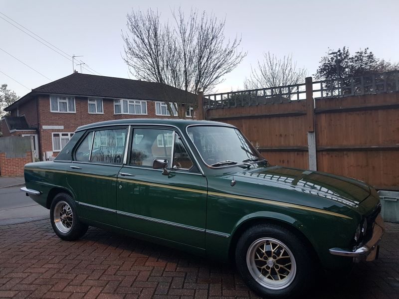

got the car out today, hydraulics on the clutch replaced, and drove back home aprox 80 miles with no issues, needs a bloody good clean and the tracking done as not happy with it since the new rack was fitted last year, ready for sunny days and the odd show

Tracking done today and it was towing out quite a bit, now it is better but still wanders a bit to me, front is poly bushed, if i remove my hands from the wheel is does keep straight, has had new rack, new poly mounts, new track rod ends, new ball joints and all poly bushed, could it be that is is lowered on koni shocks and springs?

car finished, just washed it down, has had new clutch master cylinder, new braided hose, new pipe to remote res, propshaft replaced, tracking redone, oil and filters, all ready for the first show on Saturday, just a quick polish to finish.
