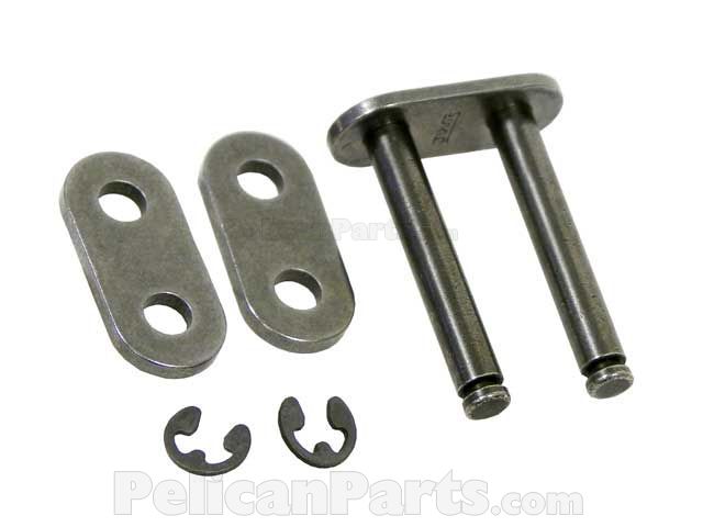

Just following up on Mark's comment, could you have a careful look at the connecting links on the timing chain please. What I'm thinking of is that if just one or 2 of the links have not been deburred they wouldn't take long to saw their way though the chain guides. Has the same problem occured to the rubber on the tensioner as well ?SprintMWU773V wrote: ↑Mon May 20, 2019 11:32 am Irrespective of Rimmer's rather unhelpful response there's still the issue of whether or not this is a recurring problem or an isolated incident.
Re: Triumph Dolomite Sprint timing chains
That is a good one. Also check the lock. Some chain's have two E-clips supplied instead of an conventional lock. This should not be assembled this way. Last year by coincidence I did notice that at a TR7. By checking the timing through the fillercap I did see and one was missing...MIG Wielder wrote: ↑Mon May 20, 2019 9:54 pmJust following up on Mark's comment, could you have a careful look at the connecting links on the timing chain please. What I'm thinking of is that if just one or 2 of the links have not been deburred they wouldn't take long to saw their way though the chain guides. Has the same problem occured to the rubber on the tensioner as well ?SprintMWU773V wrote: ↑Mon May 20, 2019 11:32 am Irrespective of Rimmer's rather unhelpful response there's still the issue of whether or not this is a recurring problem or an isolated incident.
At modern engines with plastic guides these will be fine. When a rubber/pad type guide or tensioners are grooved by wear the E-clip can pop off. The German IWIS chains do have sometimes these clips supplied but don't use these clips.
