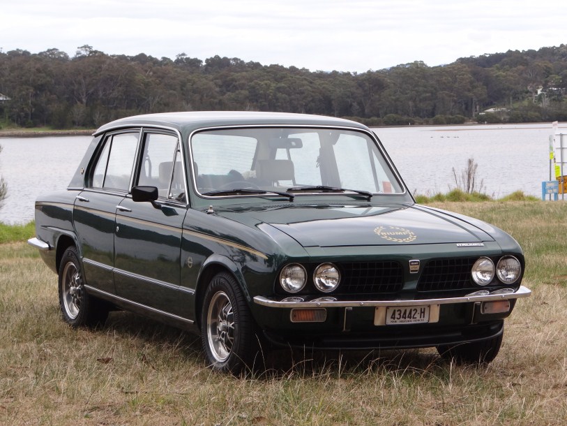

Gentlemen,
Thank you all for such a comprehensive look at what might be the problem here.
However, after sleeping on it, I've decided that I'm going to ignore it.
I have very clear memories of removing the gearbox when we changed the clutch, and to do so again, I need to rely on friends. One who owns a hoist and the other who (unlike myself) actually knows what he's doing. All 3 of us suffer from arthritis to varying degrees and I really don't want to put them, or myself, through that painful process again. No doubt this decision will be easily scoffed at by younger, flexible, fit and strong blokes. Considering that it only occurs after a longish run, and the car usually only does short runs, I can adjust my tiny brain to accept that the problem is always going to be there.
I can, and will, fix the OD problem.
The photo attached shows the offending item.
Again, thank you for your advice, suggestions and stories. I really appreciate it.
All the best,
Rob

You have a lovely looking Sprint there Sundowner, so it is a shame that the clutch problem is spoiling your enjoyment. I was following this thread with interest as my Toledo has a similar problem and my solution is the same as you - I just don't tend to go for long runs!
