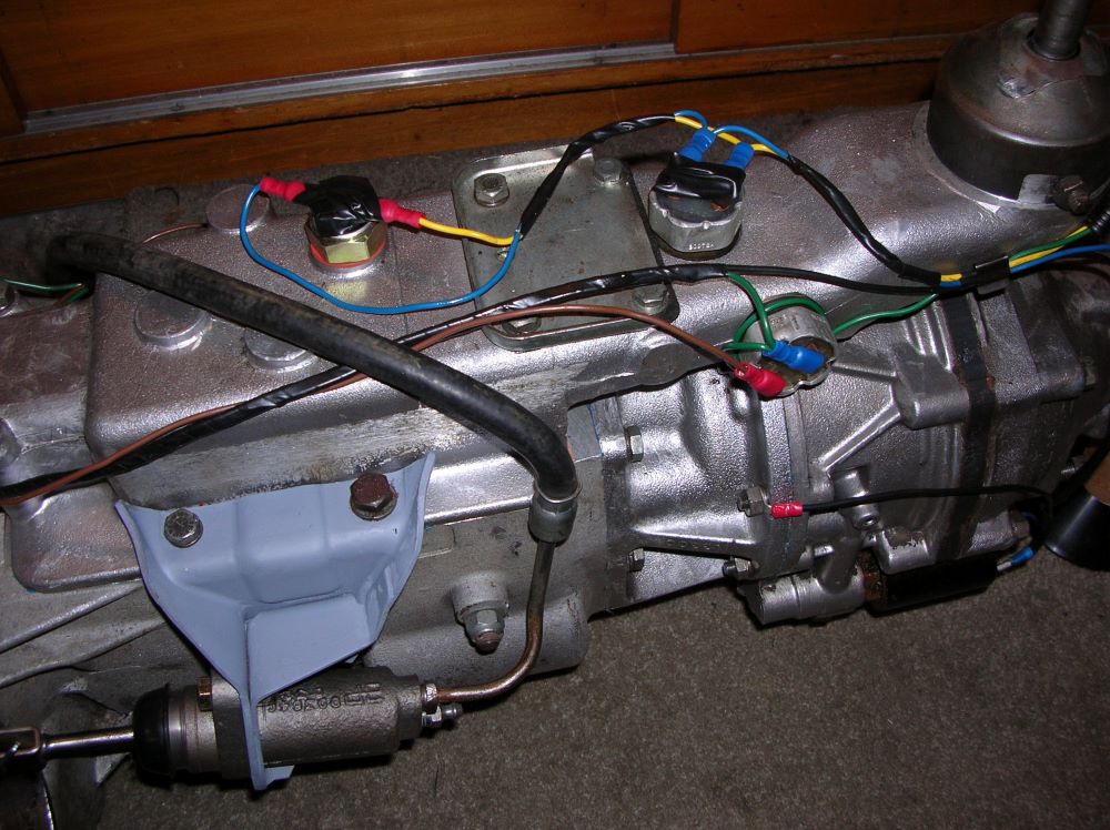

Yes, those inhibitor switches are not the most reliable, especially under extreme temperatures I’ve found. Of course not forgetting that if the gearbox oil level gets very low, overdrive won’t work either. I’ve dug out a photo of the wiring I replaced on the race car just for interest – this replaced the original that had gone hard, failed in many places and I got fed up with fixing.
Another point is check the new switch, after fitting with washers as Jeroen says, works when the gearbox is hot as well as cold. I made that mistake on an old Jag – worked fine when fitted and tested in the workshop but stopped after driving about 10km by which time the gearbox was hot and expansion affected the switch positioning.
Wiring is self explanatory with green as power from ignition, brown out to reversing lights, yellow live when gearlever switch is on and blue live to solenoid when either of the inhibitor switches are activated.

- gboxwiring.JPG (144.74 KiB) Viewed 2533 times

Thanks Geoff,
A pictures worth a thousand words.

Of the two switches on top, which appear to be wired in parrallel, which one does what?

Rear most does 3 & 4, front does 2, side activates reversing lights.GrahamFountain wrote: ↑Mon Jun 17, 2019 1:04 pm Of the two switches on top, which appear to be wired in parrallel, which one does what?

Oh well. I was hoping for a separate 4th, as I don't really want it on 3rd (or 2nd).
