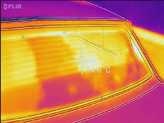

Hi Geoff, I did a thermal image of my HRW. And the answer to your question is that after 10mins with the engine running it gets to about 35 deg C. I'm not sure about the absolute accuracy of this as the rear window is reflective. I'll try again at night sometime. Certainly it got "hand hot" - about 37 deg C.
When I was repairing mine I had to use a magnifying glass to see a break across all the elements probably caused by a ringed finger running across the elements when wiping it. I found that a sharp pointed DVM test lead was not good at measuring the voltage. I used a short piece of copper braid in a croc; clip placed across the element in question.
Hope it gets sorted,
HRW On 10 min.jpg (349.76 KiB) Viewed 478 times
