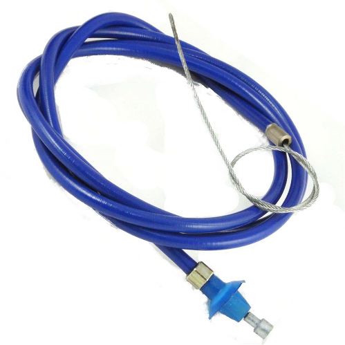

Make one yourself. Buy a good teflon lined outer cable, a decent innercable, some adjusters/ends and you can reuse the bulkheadpiece from your old cable. For a few pounds you have the best cable and the first take off will be like a rocket...

Yes but i noticed some are teflon lined and some not. They all look the same but as you can see in the pics one has a translucent fitting part and the other a solid blue. One has an crimped end and one an "open" end. Look what you buy but best is to ask the seller to phisically check his cables as some have generic pics in the advert and you receive something slightly different. These blue cables are not all the same.GTS290N wrote: ↑Wed Aug 28, 2019 9:51 pm Jeroen, didn't you recommend this before?
https://www.ebay.co.uk/itm/WEBER-DELLOR ... 1438.l2649
- cable2.jpg (20.32 KiB) Viewed 1523 times
- cable1.jpeg (24.89 KiB) Viewed 1523 times
