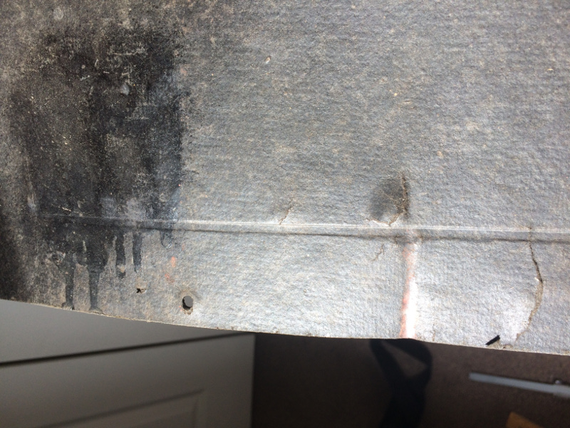

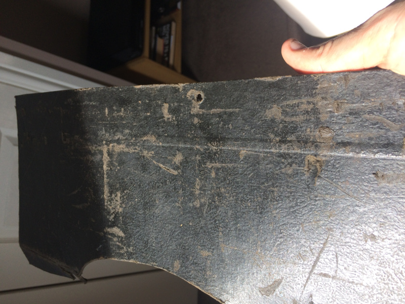

So after a bit of shonky tool making and balancing the whole lot onto the jaws of a vise which was itself sat end on to the workbench, I managed to press a crease into a bit of scrap board. The results are in the two attachments, and doesn't look all that bad - the crease is a bit thicker than standard at 5/16" instead of 1/4" but I think I could fix that by repositioning the guides, and it looks like a thinner than 1/8" creasing rule was used too.
but certainly progress.
