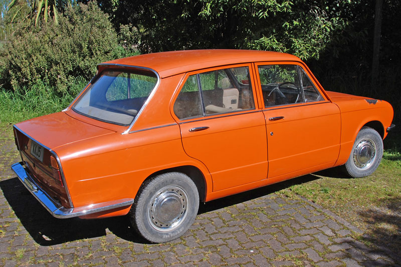

Toledo’s, both 2 and 4 door, were assembled here in New Zealand from CKD kits supplied from the UK factory. In August 2016 a Toledo appeared on trademe, the New Zealand buying and selling site. I purchased it and the project joined several others which I was working on at the time.
It was assembled and registered in November 1974. Quite a lot of work had been done on the car by the previous owner, a panel beater who had given it a quick respray in a colour which is reasonably common here in New Zealand. Some of the UK readers will notice some detail differences.

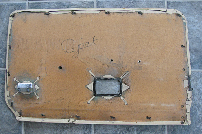

Sometimes that cleaning raises a smile for when I removed the RH front door trim to investigate the door locking mechanism the trim was marked as can be seen here.
20191018-1587Ptf KKJ 5 RH front door.jpg (165.75 KiB) Viewed 644 times

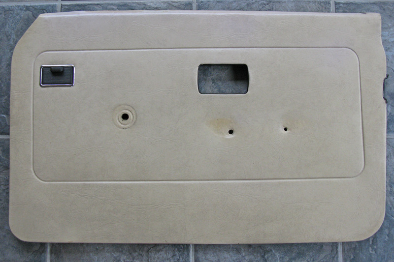

It seems that the panel was rejected (initially) but was installed anyway. It has cleaned up quite well.

Perhaps the panel was rejected in the UK and then put on the pile for NZ . A fairly typical move by the British motor industry. Still isn't it great what can be found in old cars.
