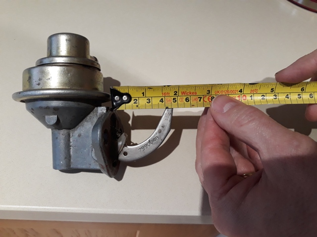

I am looking for some advice/knowledge in respect of an early short arm fuel pump for my 74 Sprint please.... I have read the many threads on the subject of pumps etc on the forum but still find myself unsure of an after market products suitability......

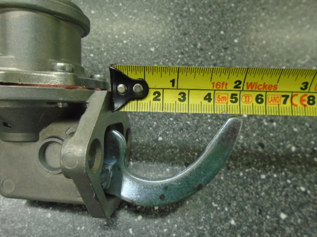

So original pump is an AC Delco (pic called resize 154419 attached) with a 46mm measurement from housing flange to top outer of arm/lever. With the many differing arm shapes and sizes, I have found at Robsport a short arm version (rare in itself i believe) with a 50mm measurement from flange to top outer of arm/lever (see pic 2). One thing of note is that on the arm of the AC Delco unit i have the number 7990048 stamped on it but other threads seem to suggest it should be 7990047... not sure of the significance of this....
Anyhow my question is how critical will 4mm be? My assumption is that this shouldn't be an issue at all, but would appreciate any input from individuals more experienced in this area than I as to whether this pump is a suitable replacement, and that it will be OK for the car.

MY opinion - and it is just that - is that I wouldn't fit that pump on my car!
Not only is the length different but the height of the end of the arm, relative to the pump body is also different, possibly by more than 4mm, it's difficult to tell! This could result in the arm dropping below the jackshaft and breaking, incorrect function of the pump stroke and early failure because of one or more of these. Or the 2 errors might cancel each other out!
So I have to ask you, "Do you feel lucky?"

I decided to check the Rimmer’s product that they would provide if you order part 312167, and what you would actually receive is a longer arm version with the measurement being 65mm (body to end of arm). So with a 13mm spacer that’s 52mm, 6mm longer than my old AC Delco unit, and 2 mm longer than the Robsport.. Absolutely nuts…

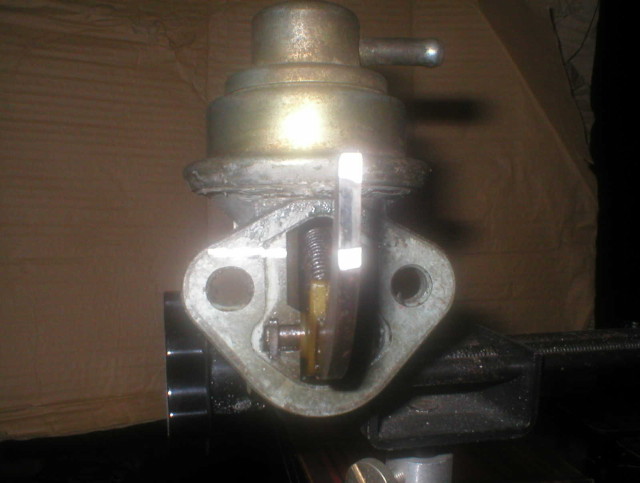

I see what Steve means. I have an old 1850 A.C. pump and the wear mark on the face of the operating arm is quite high up. I've highlighted the top and bottom parts of the wear and projected the lowest part of the wear ridge onto the pump face.Carledo wrote: ↑Tue Nov 19, 2019 11:27 pm MY opinion - and it is just that - is that I wouldn't fit that pump on my car!
Just out of interest I've also measured the lift on the jackshaft cam . It comes out as just 4.2mm.
