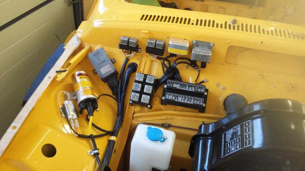

I've mostly paid the price and bought my relay holders (I like the ones that lock together and also hold 3 fuses each) from Car Builder Solutions.
However, due to their rather exorbitant P+P charges, it's best to make a comprehensive list of everything you want and get it all in 1 hit!
They also do a rather nice line in blade fuse boxes, offering a number of capacity choices up to the 16 fuse behemoth that I ended up using on my Sprint! Big it may be, but it's still compact enough to fit the original site!
This has a built in facility to siamese a number of fuses to a common feed or feed them individually as required, which is handy!
Relays I buy off ebay, just whatever is cheap, I pay under £3 each mostly, for 30 or 40amp relays.

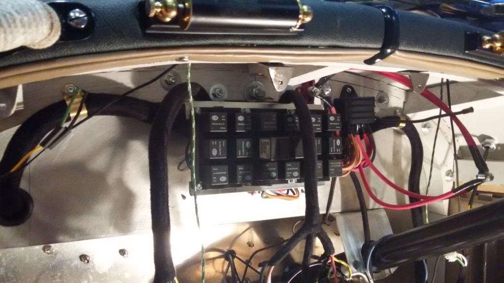

As to just WHAT to fit relays to, that's a personal choice! You can get away with as little as 2 for the headlamps or get totally anal like I have with 12, covering Dip, Main, Starter, Horn, Spotlights, Engine management, Fuel pump, HRW, Rad fan, Leccy windows, Central locking and a catch-all Ignition live booster relay for a number of ignition powered components like the auto trans ECU, immobiliser, reverse lights and other odds and ends. Some of these you won't have (maybe 5 of them) but you get the idea!
I've also incorporated a grand total of 21 fuses in 2 boxes! I DEFINITELY watch too much Project Binky!

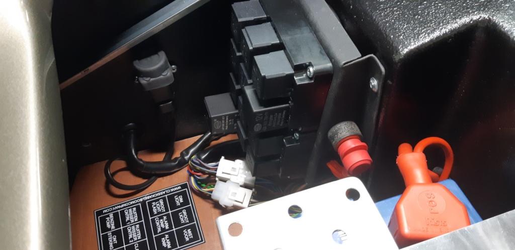

I used the same fuse board as Steve but got mine from EBay

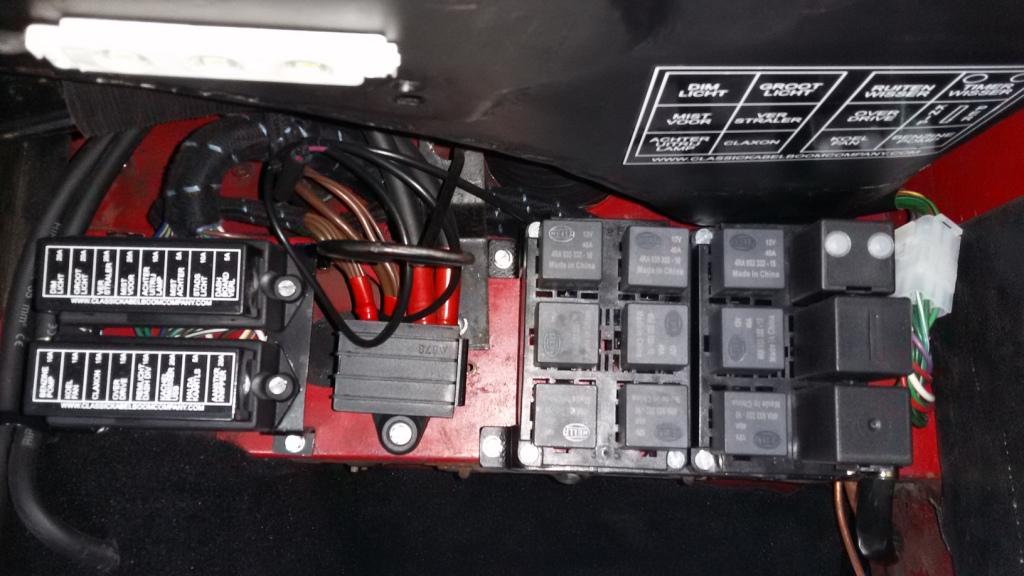

I have 4 of these in a metal frame under the dash in the Spitfire.

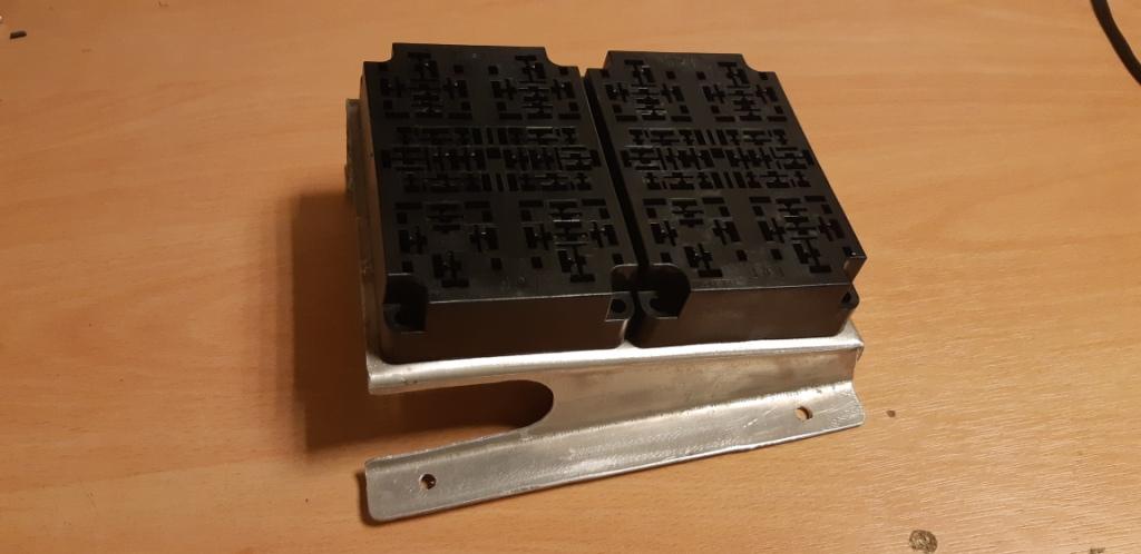

Re: Relay / fuse board
When i have to use multiple relay's this holder I use.
https://www.3waycomponents.co.uk/Relay- ... ay-Holders
Easy to fit and a neat solution.
