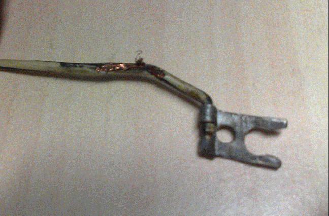

3. Can you also check the same wire where it goes round to the points inside the dizzy. Here is a piccy.

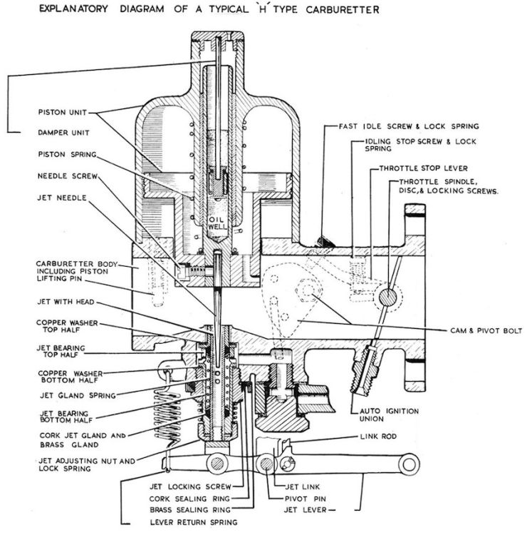

Re: My 1850 is playing silly games
The dashpot oil in an SU carb is in a closed metal tube. There is nowhere for it to go. The diagram is of an older type, but the dashpot is the same on later versions.
