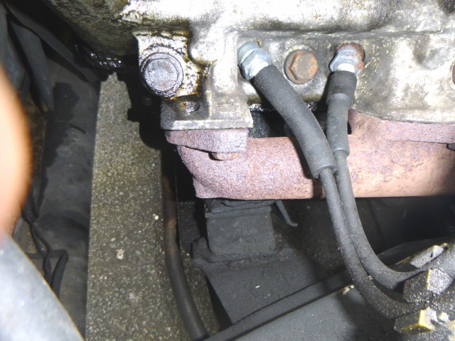

Hi Richard, I've had a look at my 1850 and both of these brackets ( snubbers ?) are fitted to the rear of the rubber engine mounting, so mine is arranged to stop the engine moving forwards too far.
Do they work ? Well yes , I think they do because my nearside one is bent outwards from the rubber mount at an angle of 30 degrees. So it feels like time for a new n/s mount even though it looks O.K.

As promised here is a photo of my nearside 1850 engine mount with the restrictor under the exhaust manifold.
You can see how much it is bent backwards. So yes; they do seem to work.
Now how to bend it back ... ?
