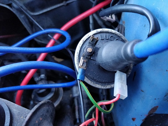

As for the coil, it doesn't really matter, as long as it has the right resistance rating. You can use a multimeter to check the resistance of the primary coil on your current coil, 1.5 ohm for a balast system, 3 ohm for 12 volt system.
When you wired up the britpart kit, did you use a 12 volt supply? If you take the power off the coil of balast system, the module will get 6 volts instead of 12. It will probably work but it won't be good for its longevity.
The coil in your link looks to be right for a balast system. I would be a little careful buying off ebay, some of the coils sold there are made of cheese but if you trust the seller, it shouldn't be an issue.

I will check the coil tonight and confirm if its a ballast or not.
Thanks
Barry

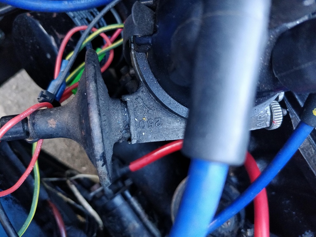

- Dizzy
- Distributor tag.jpg (262.52 KiB) Viewed 1858 times
- Coil
- Coil top.jpg (102.84 KiB) Viewed 1858 times

Fitted everything back the way it was fitted, but it looks like the pick up to the coil is fitted the wrong way round (positive to negative ect) but it runs well.
Would it cause an issue if I swapped it over, and why is one lead shorter than the other?

The worst thing that can happen is you fry the module! This is exactly whay happened to a mate with a 1500 Midget, he put the wires back on the wrong coil terminals. It killed the module instantly, didn't even fire up till I put a new one in!
