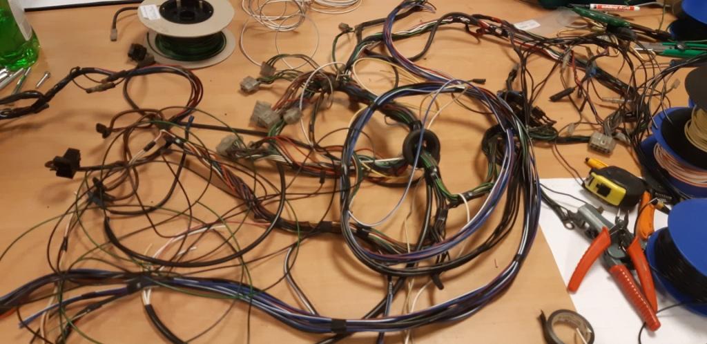

Re: Wiring harness's
A Dolomite harness can be repaired or modified easily. New or used one. The one below is from a fellow UK Dolomite owner and the halogen conversion/new wires will be in the exisiting harness with the relays inside the car. The wiring is modified for fitting a Roose radiator and fan also with the relay inside the car behind the dash. The ballast ignition system is modified and instead of the starter contact the 12v feed during starting will be through a seperate relay. A 12v ignition feed is added next to the coil so in the future an electronic ignition is easy to connect. The wiring is split up in more groups and will accept a Lucas 4 fuse fusebox. One extra fuse for the fan and the ignition fed items have two instead of one fuse.
Damaged wires are replaced and the starter inhibitor loop will be removed and a new wire will be fitted from the starter switch connector directly to the starter as his car is a manual. All will be taped again using Lucas type tape and in this case the overall look will be like original. This is a good used harness but this kind of mods I also do on new harnesses when extra spots are wanted or when an alternator will be used instead of a generator.
Steve (Carledo) is in quarantaine I believe and I think he can do such modifications in short time. When you are not desperately in need you can send a harness to me.
