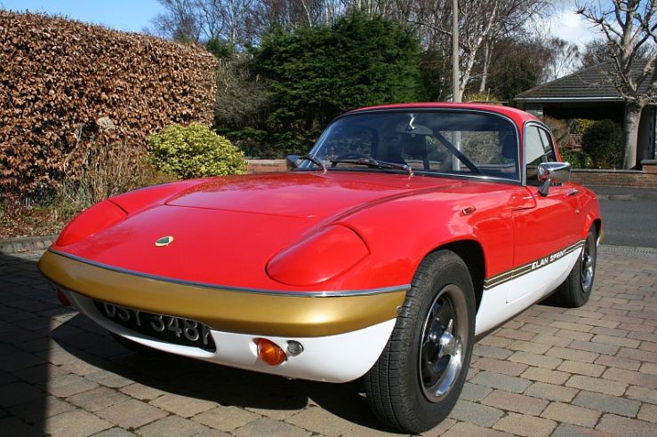

I once hand painted a Lotus Elan with International Yacht "Perfection" paint and after sanding the brush marks and polishing, looked a million dollars. But you can't buy that in any colour, just a select range of basics. Fortunately the red and white were perfect for the Elan Sprint. See for yourself.

In the case of my Elan, it took me all summer to fully paint the body, but then it is fibreglass and has a special set of problems. First I had to strip the terrible paint job the PO had done with water-based paint stripper. This exposed some gel coat damage, so I contacted International Paints and they couldn't have been more helpful. The procedure was to sand, then put on two coats of primer. Then, and only then the gel damage was fixed with their "Watertite" epoxy filler. Incidentally this is expensive but superb, and I use it on all filling jobs on steel cars too. Unlike ordinary fillers it is waterproof and is extremely smooth.
Once the filler was smoothed down, there were three more coats of primer, sanded in between, then three coats of Perfection undercoat, more sanding, then at least three coats of top coat. It looked terrific and VERY glossy, but with brush marks. Then once it had hardened for a week or so, lots more sanding, and then final buffing with a machine to achieve a lovely finish.
Hours and hours of work but a great result. Paint shops that know about fibreglass cars will charge £8000 - £10,000 to fully do an Elan, and now I know why. My time is free and the products used cost about £300 at a guess.
