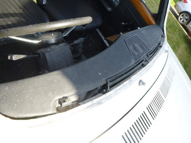

Remove wiper arms.
Remove the plastic-chrome filler strip.
Remove the heater vent duct inside. ( 3 screws).
I then ran a sharp knife all around in the filler strip groove.

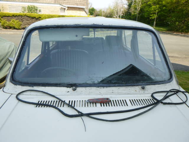

It was still reluctant to come out so I cut a lot deeper into the rubber; and it moved.
The last thing I wanted was to break the screen, as SWK is a daily driver.
I removed the old seal, and cleaned up the screen. This took a long time as there was a lot of old sealants and gunge around.
I then cleaned up the aperture, which was surprisingly rust free.

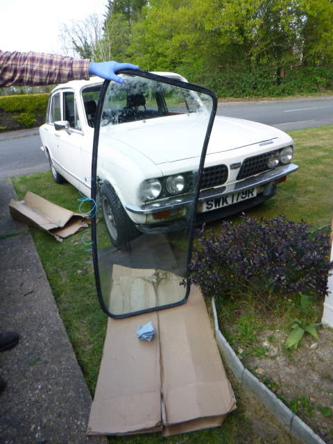

I used a Seelastic clear silicone sealant on the new seal and ran it round the screen. So far so good.
I used 18 feet of thick strimmer line in the inner recess after filling this groove in the rubber with sealant as well and putting a smear of sealant all the way round the aperture to help it slide in .
Fitting screen + seal is tricky. It needs to go in square and needs gentle even pressure all round to help it in.
I concentrated on the lower edge and pulling on the strimmer line seated the seal O.K. It helps to have help pushing gently outside the screen while I pulled on the line. Up the left side and the top bit went O.K. except my roof lining was dry and cracked under the old seal. I think I should have glued this bit first.

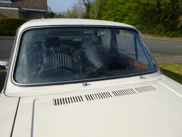

I then used the sealant gun around the edge on the outside.
What did take the time was cleaning off the screen of sealant fingerprints and excess sealant. Thanks for the hint on white spirit; this works well. This is probably why fitters tend to fit screens dry. It also makes them a lot easier to remove.
I even washed the car and so far so good. No screen leaks !
I used red rubber brake grease in the plastic chrome trim groove. This was no trouble and went straight in. I didn't need the special fitting tool I had bought. But I've dropped the finisher somewhere, so for now there is a gap.
