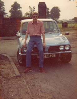

Here's a picture of me and the Dolly in circa 1983

Was your 1850 in the photo painted in Ice Blue ?
That is quite an unusual colour.

I don't really know what colour it was. I kept it about 18 months but never undertook any body repairs, only rear shocks I changed to Spax adjustable and engine fettling. It was faded in parts but in pretty good all-round condition. But that's the colour I want... or very similar.
