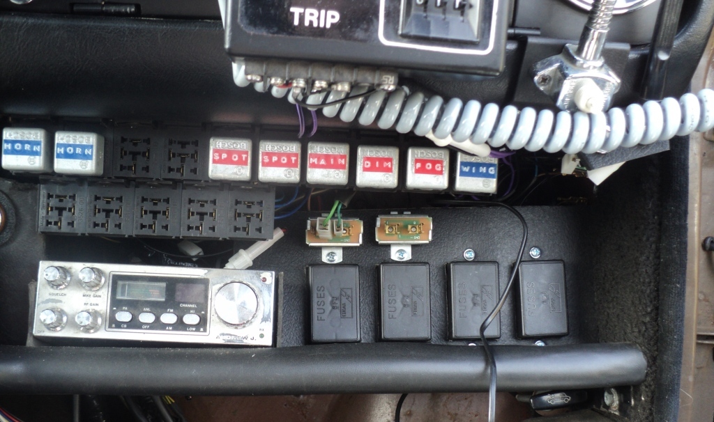

I made many custom panels and also Dolomite parcel shelves from grained alloy sheet. This sheet you can cut with your child's hobby scissors and bend on the edge of the kitchen table. You can crumble it with your hands when needed and in a case of an accident these panels don't harm.
You can pop rivet a Dolomite parcelshelf together like the original. Sprayed black it's just like the original but not concours original.
Don't look at the mess around the dash, an old pic but you can see the grain here. This I made of the alloy and sprayed it black.
I also made the boards next to the radiator on my 1300 with these. I only made a double folded edge to have it more rigid so it look thicker there than it actually is.
