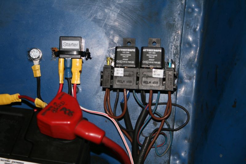

A couple of years ago I realised that I could fit relays into the headlight circuits without having to cut any of the original wiring by making use of the three way connectors that feed the headlight fittings. This can be done by basically disconnection connector nearest the battery and then using the disconnected socket section to control the relays and then taking wires from the relays to feed the three pin plug section of the connector that was disconnected. It is then just a matter of disconnecting the headlight connector on the other side of the car and connecting three wires from the disconnected connector plug back to the relays. The other half of the disconnected connector, the socket, is now effectively redundant and can just be blanked off and tucked out of the way. Having more time, due to being in lock down, I have made use of the time available to make a new tidier installation. I will in due course produce an article for inclusion in an edition of Dolly Mixtures in which I will detail the bits required and how to do it. I have attached a photograph showing how the relays can be sited just above the battery using the two existing spare tapped holes that are there and a photo of my new kit ready to be fitted.

I have now produced an article which gives the details of what bits I purchased to produce the kit and how I wired the items. What I like about my method is that I did not have to cut any existing wires as it makes use of the existing plugs and socket connectors. I will be sending it off to Steve Waldenberg for him to consider for inclusion in the August/ September edition of Dolly Mixture.
To finish the installation off I have even produced a cover to go over the relays. This is shown in the following photograph

The detail of how I installed the relays is covered in an article in issue 198 August-September 2020. What I like about my fitment is that you do not cut any wires. You do need to purchase some three way connectors as well as the relay but by doing this you are able to disconnect the existing connectors and just plug in the modification.
All my cars are 1977 or later 1500HLs and I believe that all dolomites in this age group are basically the same but just with the battery on the other side of the engine compartment. Earlier cars may have a different type of three way connector.

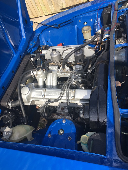

The relays are fitted under the battery on the chassis leg where the original harness runs. From that location on the harness is completely new to the lamps and horn but without the dividing knots having every lamp its complete own lead. The main feed take off is at the battery lead connector where the alternator wires are connected. All is fresh with new wires but without the wiring mess and relays visible on the inner wing.

I’ve got one of Jeroen’s Front looms on my sprint.
Mine has relays for lights (inner and outer beams) horn and the kenlowe fan.
Discreet, tidy, functional, well thought out, and easy to fit, even for a ham fisted amateur like me.
As Jeroen mentions, the relays are fitted under the battery on the chassis leg, neat, out of the way and means there’s no extra wires lying around the engine bay.
Brings reliability to 45 yr old electrics!! (I was having problems before I put it in!!)
Highly recommended
