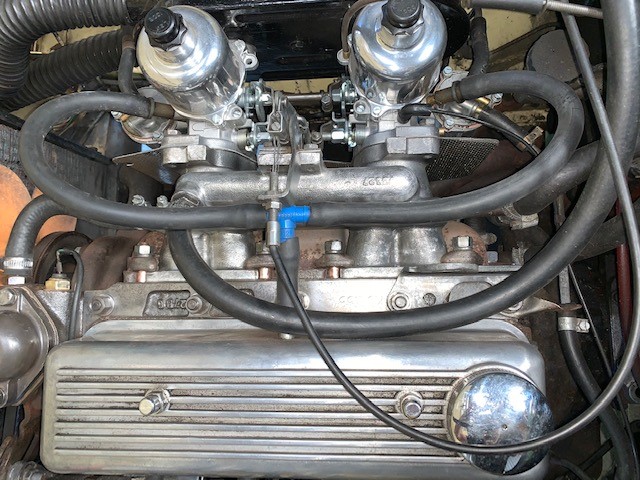

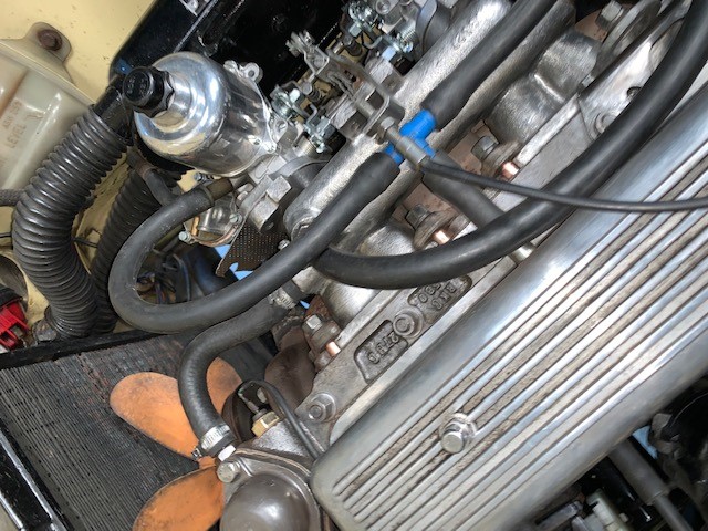

So, what do you think? I've added some pictures of the car as it is now, and the MOT doc. And you can see alot more pictures, videos and details of the work that i've done on my Instagram account: colinwoods_is_me
