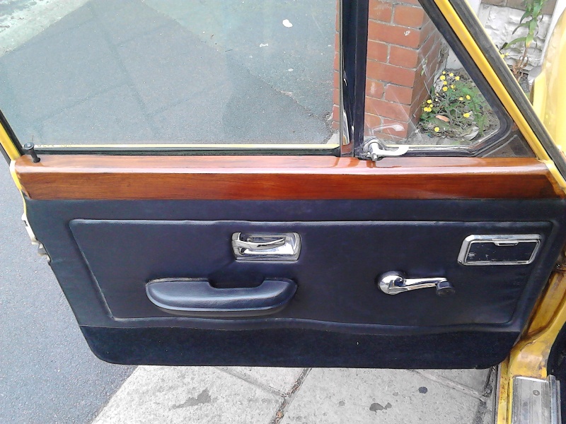

I've got bits of a few sets of the wooden door caps, which I've been looking at to re-furbish. Am I right in thinking some are veneered over three surfaces, side, top, and bevel, and some are only veneered on the main side face?
If so, does anybody know if there's a pattern to type of dolomite and year, etc.?
Graham
Graham

They were only veneered on the vertical face originally. I think I recall the SE, which had burr walnut veneer, rather than standard crown cut walnut, may have had all three faces veneered, but will be happy to be corrected...

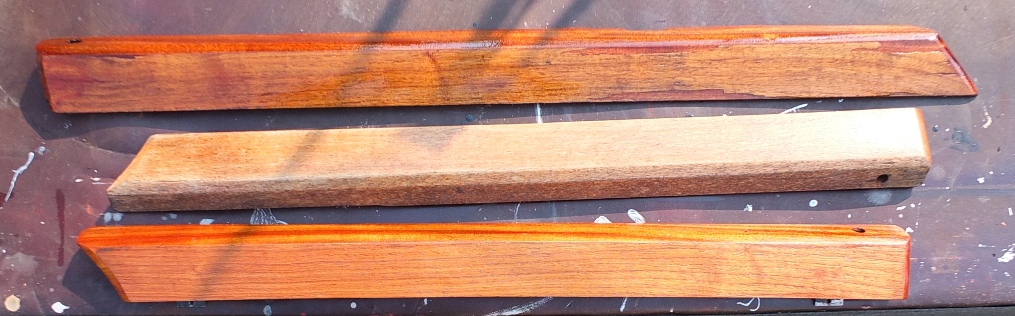

I've now found one, off a brown painted door, that's not veneered at all. It looked like it was original: the varnish was thin but clearly professionally done, with crisp edges where the driver's arm hadn't worn. Also, where it was continuous it took three coats of stripper and some real work with a scraper to get off.
And now it's clean, I can see the grain runs across the bevel from side to top, and round the ends. This is the pale one in the first picture laid across the wire wheel. Interestingly, the back face is the palest of all the ones I have.
The ones that look like they're fully veneered have been restored (badly) with a seriously think coat of pale, possibly clear, varnish that's run a lot. But looking at the damage under that, there looks to bits of veneer missing from the tops and bevels. But I admit, the varnish is that thick, it's hard to tell.
These are the ones I've rubbed down a bit and slapped some ronseal dark walnut over, to fit temporally while I do something better with the original ones.
I'm playing with some spares caps and glove box doors to see what to do with the original ones. I like the colour the Ronseal gives over the pale varnish (on the car doors). But this dark walnut is a bit too dark on wood thats been stripped bare (dark one in first picture on wire wheel). It's also going to need a lot more work first or a lot of well rubbed down coats of clear varnish on top to get a good finish. I may strip, spray with clear, and then sponge with the Ronseal to see what that gives. It should be possible to re-strip after that without much lasting effect.
I've also got a problem in that what came with the car isn't a set - the drivers door one is this un-veneered oddity -, and the front passenger one's in a real poor state, with big bits of veneer missing and more split and lifting. The back ones aren't too bad - mostly just faded. So it may be interesting getting them all to match.
Then there's the dash.
Graham
Graham

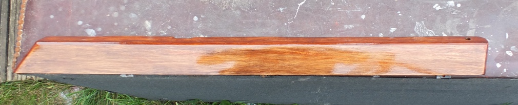

I've had a go at the cap with no veneer to fake it up a bit. The grain's not very good, but the colour ain't too far off the original ones I've sanded down and re-varnished. I like the bits where it looks like where the original ones had been sanded through the veneer in production. It's the inverse of that, but it looks real.
The varnish is poundland's best Yacht Varnish. Needs another coat or two, but it turns out to be nearly as good as the proper stuff, at less than 1/5th the price. Mostly it's a bit thinner.
I'm in two minds about whether, having found how to get the colour I want, I should strip it again and re-do, or use as is, since I don't want to hide the fact it's not a right one, just tricked up to look right from across the road.
Graham
Graham
