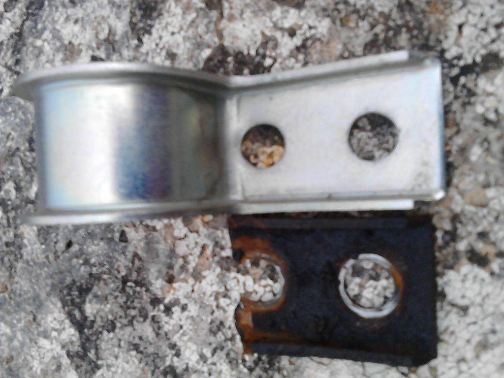

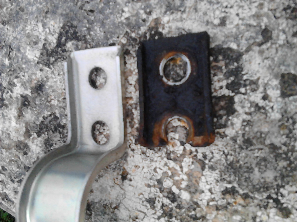

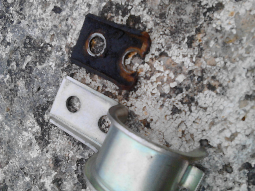

I'm using new ones. I think the last one came from S&S, but they'll have got it sent from gRimmers. The one I have just put on, and the one in the photos came from Wins. I got two from them because they were less then £3 more than one from Rimmers. So If I do strengthen it, it's a straight swap.
The bit of the old one that's left looks the same as the new one to me. I do note it's broken about where there are two pressing marks in the new one, and it is where I'd expect maximum stresses and fatigue failure.
I can't see any issues with the roll bar or subframe, spacings look the same both sides and no obvious bends in anything. I didn't mention poly bushes, but they are blue ones.

I can't see or measure any differences between the new one and the bit of the old one I have left that's not probably due to the way it's failed: the sidewalls are splayed at the ends of the break, suggesting to me it failed at the mounting hole and the crack spread outwards. To look at them, they could well have been made by the same tooling.

We had a bit of a discussion about the way the bottom hole is elongated in the fabrication process, and they think it failing there and spreading sideways at least sounds credible. Like I say, the sidewalls are both splayed, and at least one of them wouldn't both be so distorted if it started at one or both of them and went right across or in. But as to why, they don't know. Also, the broken bit is bowed across the width showing it was loaded against the bolts. But I don't know why it would be excessively loaded.
The other thing is that the bit the ? hooks into is fine, and there's not that much metal in the hook or eye. So I don't know how there can be so much load on the bend and little on the hook or eye. It has to be a fatigue failure in the movement the hook and eye allow.
That makes me wonder if gussets in the corners of that bend will help. They would have to somehow take the load of the mounting hole, and I'm not sure they wouldn't transfer more there, rather than less. Maybe the answer would be to weld the hole up and re-drill it round. That would put some metal under the bolt head between the hole and the bend, where there's currently none, or at least not much.
