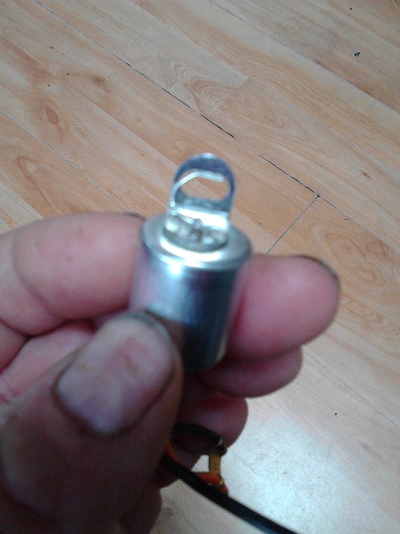

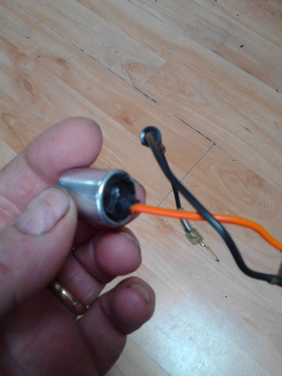

The 400V 0.22uF PCB caps arrived. So I've stuck one in a can from a Lucas one that died. Cos it's an aluminium can, I can't solder the earth side to the can, just lock it in place with a blob in the hole. So the wire has to go to the mounting screw and be held down by the flag ring on the end of the earth strap.
I'd go fit it, but it's the rainy season again. Actually, I think I'll stick it in the spare and give the Distributor Doctor's one a propper go. If I just got dodgy condensers from two suppliers, that should sort it.
I also thought to check that the resistance wire is doing its job when the system's reached temperature, and the coil voltage with the points closed goes from 5.8 to 6.5, which is probably mostly the battery taking a bit charge.
Graham
