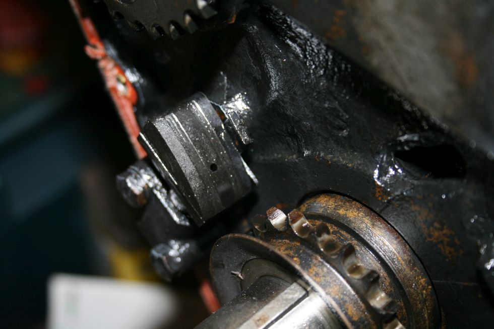

Here's a picture of the original tensioner from my 70,000 mile 1850. I simply reused it because of all the tales of Rolon tensioners parting company with the base. The engine runs well with no undue chain noise.
Damson6
Posts: 18
Joined: Tue Jul 28, 2020 8:11 pm
Re: Timing Chain Tensioner
#6 Post by Damson6 »
Bumpa wrote: Sat Sep 26, 2020 7:47 pm Here's a picture of the original tensioner from my 70,000 mile 1850. I simply reused it because of all the tales of Rolon tensioners parting company with the base. The engine runs well with no undue chain noise.
Thanks for the picture, mine doesn't look too different to yours so I might check and reuse!
