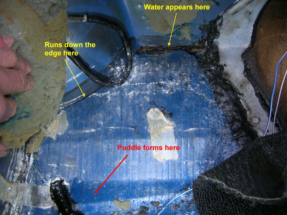

I am determined to fix the wet footwell on my 1977 1850HL. If you look at my photo you will see that the water appears at the joint where the vertical panel meets the floor, tracks along the top of the anti-drumming surface, then spills over to form a puddle as indicated.
There is no corrosion in the bulkhead area and all welded joints look fine, but the water must get in somehow. Has anyone had a similar problem and how can it be fixed? I hate a car with wet floors.

After much work I am sure that the water does not come from above. Today I have stripped off some of the sound deadening from the engine side of the bulkhead and I directed a thin jet of water from within the engine bay directly onto the bulkhead, and the familiar beads of water appeared inside as per my photo. I am convinced (almost) that it penetrates the seam between the vertical bulkhead and the floor. I'm going to slap some sealer over this area under the bonnet and see what happens.

That's it Richard. The arrow on the right of your picture deposits the water on top of the joint between the bulkhead and the floor and the inner wing, and that's where I think the water somehow seeps through that joint. The design allows a small amount to collect there. I slapped a load of sealant on that seam last night and must use the hose to see if I have have stopped it. But although it's sunny here this morning, it's a tad chilly at the moment!
