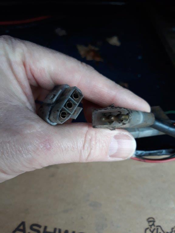

Hi All
The Subject are not connected "except" that I am after some views on them both pls.... :D :D
Firstly I am trying to establish if the connectors for the lights, see pic, are available to buy anywhere... Anyone know please? I need to clean mine up but wanted to understand if they are available should I need any..??
Second, anyone have any experiences or suggestions of where to get a carpet set for the Sprint.. Considering a new set but want something decent and not cheap and poor quality.. So any experiences or recommendations please..??

The connectors are available from Autosparks Ltd. www.autosparks.co.uk Part C823 3Way 3mm Pin and Socket Connector @£11.08 each

Hi - Richard beat me to it; but the Autosparks option is pretty expensive.
I can pass on some advice I got from Jeroen (he did a great job of building me a headlight loom recently) around removing wires and cleaning them up, its pretty easy and a lot less expensive than dropping £11 on each one.
Basically, if you use a metal terminal to push onto the contacts you can pull the wires out easily and intact from behind, and then it is just a simple case of cleaning up the plastic of the terminals and plugging them wires back in, again from behind
You can also buy terminal removal tools online, but actually I found using a terminal itself to be much easier.
Ian

i bought the 4 way version to use on my headlights,but had trouble with them,the female end didnt lock the pins in position,after getting them replaced twice, went over to the modern water proof type

I had trouble getting one of the 3-way body mating halves new, and got some used ones from Steve at S&S preparations 01706 874874 - there're everywhere on the TR7s and he has a few spares.
If you're rewiring with new pins, there's no issues I know of in using used bodies, and if you want a few, it could be cost effective if you can bargain.

When physically undamaged you can easily re use the old plastic housings as I mainly do. Some insist new and they can have new and at some cars there is no alternative than to re use. New wires with new terminals crimped on pushed in the old plastic housings.
The one in the picture is a different type than the more popular rounded versions like the ones on the autosparks website. These in the picture use also different terminal thans the autosparks ones. These will fit but the locking tab is on a different location making the terminal too deep into the housing barely touching eachother.
To remove the female terminal the DIY can use a std round female 4,5mm terminal that goes tight around bending the tabs back. For removing the male terminals you can use an old female you just took out.
Jeroen.

My attitude, when they go wrong, is to bin them and replace them with more modern ones. Once the corrosion gets into the electrics too deep, it difficult to clean the terminals enough to get them working reliably.
OK I get it if you want originality but my view on this is, who cares what style of electrical connectors are fitted. As long as they work.

I have almost finished the restoration of a Sprint. Before refitting the wiring loom I bead blasted all the terminals, and spliced in fresh wire where it had hardened. However the plastic bodies of the connectors under the bonnet were to brittle and needed replacing. No supplier seemed to have stock of the original Rist's type. I found suitable alternatives at a reasonable price from:- https://www.autoelectricsupplies.co.uk/category/1 or simply search AES.

Connector looks similar to Lucas rists and molex but not the same as either.
https://www.autoelectricsupplies.co.uk/ ... category/7
Hmmm, sounds like Mr. Jeroen is the man in the know about these though.

Why do you say those pictured aren't the Lucas RISTS 3mm pin connectors? I got to find the box with the spare ones in to be sure, but they look like what I remember.

yorkshire_spam wrote: Connector looks similar to Lucas rists and molex but not the same as either.
These are both Lucas connectors, the one in the pic of the original post and the more common rounded ones found in most of the Dolomites. These connectors have both different type pin terminals that only fit in their own type housing aldough both are 3mm.The two types found on the dolomites also don't mate with eachother. The housings have a different shape.
There are more types of Rists connectors having their own terminals. The '80s ones look very similar but the housings have a second lock and so very different terminals.
The Molex ones are totally different.
