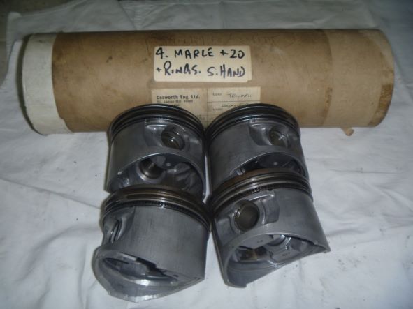

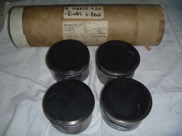

Do you have a set of +020" sprint pistons for sale?
No49 wrote: ↑Wed Oct 20, 2021 8:43 pm If you still need pistons, we have had a sort out and have several sets of pistons, different bores, std and forged/cosworth new. Also some more used sets both std/cos etc.
These and many other parts will be for sale soon, will go in parts for sale section first.
In relation to the comment above, we also have three 1850 engines complete.
Send a message if you are interested.
Re: Sprint pistons ?
Yes we have used MAHLE PISTONS & RINGS +20
Other than that, we only have std bore left, second hand and new.
Cheers,
Mark.
Cheers,
Mark.
