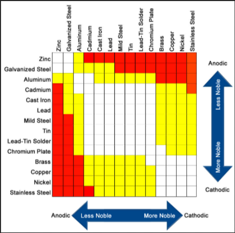

if you look at a galvanic corrosion chart, stainless steel and aluminium is worse than steel and aluminium.
- Galv table.png (90.64 KiB) Viewed 2079 times

Is the issue galvanic corrosion generally? Certainly the old studs on mine were heavily corroded and swollen, stainless would at least avoid this problem. Combine with some anti-seize compound for best protection?

It's almost common knowlegde that stainless steel and alloy don't work together. Putting an anti-seize compound or copaslib even makes it worse as it works as a conductor between the two. There are a lot of motorcycle restorers in the past that found out the nice stainless bolts used in the alloy enginehalves were falling out after years because of the threads had corroded out...matt of the vivas wrote: Is the issue galvanic corrosion generally? Certainly the old studs on mine were heavily corroded and swollen, stainless would at least avoid this problem. Combine with some anti-seize compound for best protection?
First lesson at the first class of the restorers school. Don't put stainless steel near alloy.
