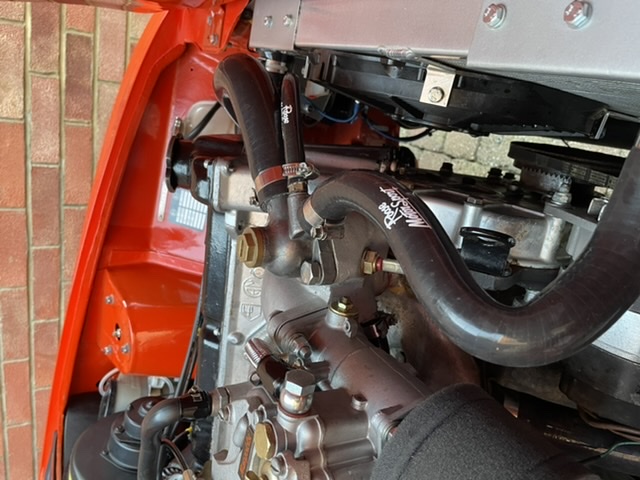

Malsprint
Posts: 67
Location: USA
Re: Coolant Leak Rubber vs Silicone
#7 Post by Malsprint »
I eventually fitted new silicon hoses purchased from Roose Motorsports. I ordered the original finish. I was disappointed when they arrived because they had the Roose Motorsports logo plastered all over them which wasnt the look I was going for. But Roose Motorsport replaced them with no fuss whatsoever even through they had to resend to the US. Excellent customer service.
I am not sure but I think you have the option to select if you want to have the logo or not when you order, and it may well have been my error in not making the correct selection in the first place. If you order these be sure to look out for this.
I also ordered a new radiator with electric fan from them which is very nice indeed.
And so far no leaks. I didnt use any sealant. I figured I would try without first.
