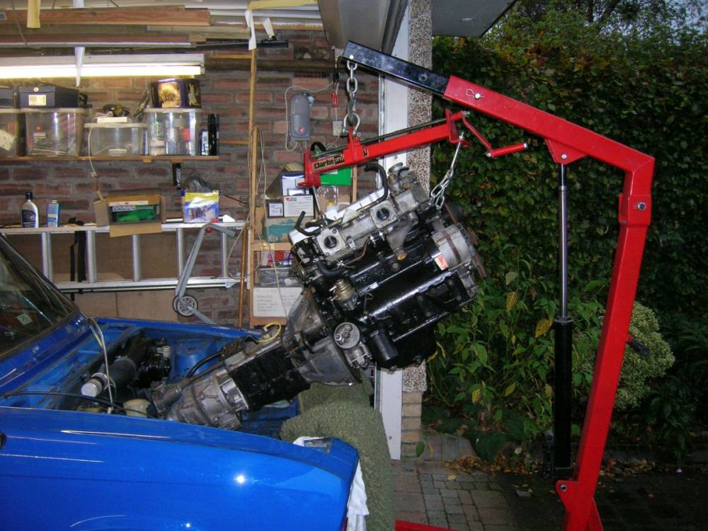

Likewise, mine went in the top without too much bother. An old rug over the front of the body and a load leveller on the crane. I did it entirely single handed.
- Engine In 1.jpg (148.51 KiB) Viewed 452 times
