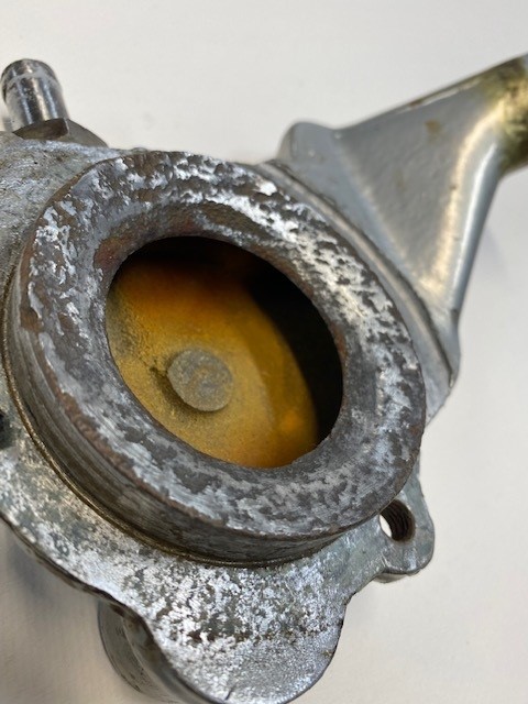

Looking at the fitting instructions for the pump housing (12 vane) and the need to use different gaskets of different thicknesses. I assume that the dimension between the rotor and the bottom face of the pump housing is critical to the efficiency of the pump.
Mine is very badly pitted. Or at least I think it is but I have never seen a new one so I am not sure what is expected or acceptable.
I notice that replacements are very cheap which make me concerned about the quality. Mike (Project PFJ) where did you get your pump housing from and how is the quality.
Second question. What is the size of the heater hose fitting. I very much doubt I am going to get it out.

I don't think the pitted face will affect the efficiency of the pump. The shims are to limit the end float and to ensure that the vanes do not rise up excessivley and make contact with the chamfered face.
The dimension/clearance between the vanes and the chamfer is key to the efficiency of the pump.

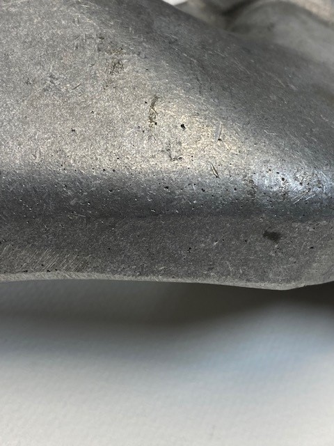

The pitting I am concerned about is on the chamfered face. This photo shows it up better than the previous one.
I expect that this would decrease the efficiency of the pump.

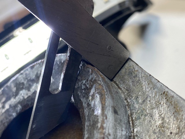

I managed to get the fitting out using a g-clamp to put pressure on the spanner.
I am will still get a one as recommend by Mike since the hose fitting is quite pitted.

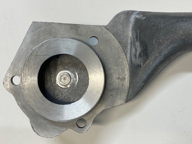

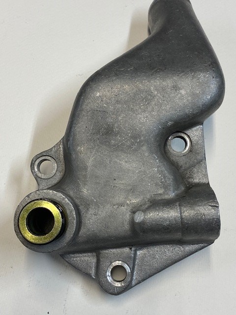

I got a new pump housing from RBros.
Given the price of GBP23.00 I was expecting it to be very poor quality. Much to my surprise its actually not bad. There is a little bit of porosity, the machining looks quite good. The only stupid issue is that the machined flat on top of the bolt holes is too small to take a flat washer. Even a spring washer is a tad too big. It would have been just as easy to machine this to the right size rather than the wrong size.
I have reduced the diameter of some spring washers by filing them while spinning them in a drill.

Malsprint wrote: Sat Mar 05, 2022 9:51 pm I managed to get the fitting out using a g-clamp to put pressure on the spanner.
I find the best way to undo fittings like that in aluminium is a GENTLE amount of heat. Brute force often breaks stuff and don't ask me how I know that. I warm it gently over an old camping stove and it works every time.

I take back my original comment about the pump housing being of reasonable quality. From the photo you can see that the bolt holes are rotated anti clockwise. To the extent that the head of a bolt fouls on the body of the pump. This also causes the pump to be rotated out of position when fitted so that the bypass tube doesnt align with the hole in the manifold above.
I have asked RBros to check if all of their stock is like this and if not to provide a replacement. I will keep you posted.
