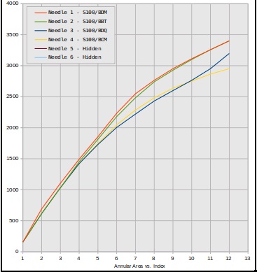

Sat looks a good day to do the jets - they are up at the step to get idle mixture right, when running it's a fortnight (no I checked the float levels are okay). And when set so the car runs right, the plugs foul on idle.
Still waiting for the new needles: they're BDMs, which are nearly the same as, only a tiny bit richer in the mid-range than, BBTs, but were like 1/3rd the price. And I've a set of weaker BDQs to put in pro temps. I used BDMs in ATR 716V with K&Ns. So I'm happy they'll be close enough. I'll see which are best between the BDMs and the BDQs. But erring to the rich (would the opposite be airing to the weak?) seems good if I'm looking to being able to run on 95 RON.
Graham
