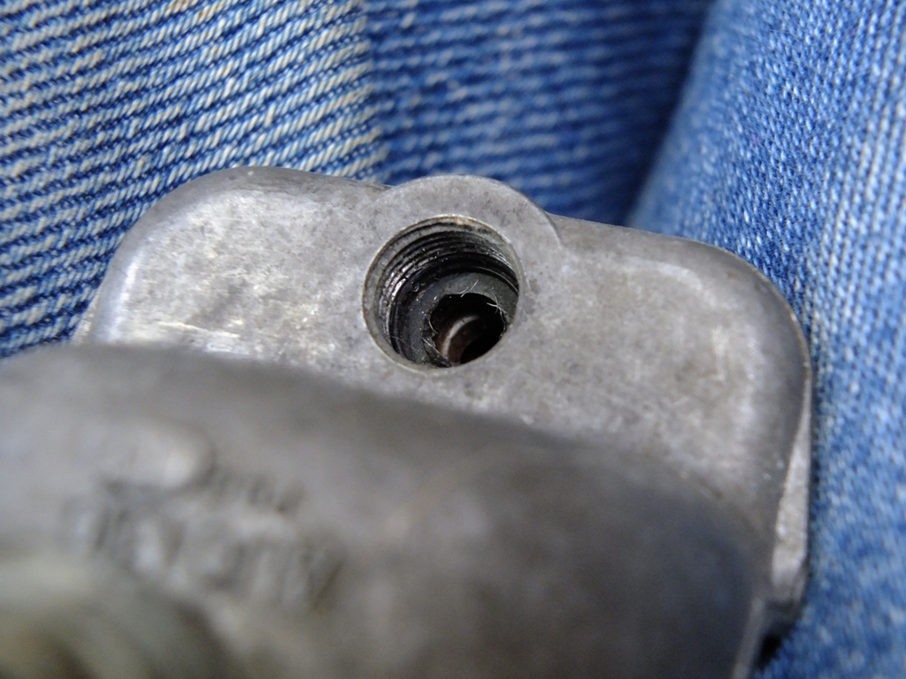

Well I can say that the four I looked at, which I think were all as they left the factory, had the steel washer in first. I accept that the replacement jets come with the steel washer up against the gland nut. But steel washer in first looks like the way SU assembled them at the works. It didn't leak like that round, by the way.
Here's a picture of the only one of the four chambers I have to hand that I haven't taken the washers out of. You can see the indent from the back face of the gland nut in the outer face of the rubber, and you can just make out the steel washer behind it.
I wonder if Alun has taken any apart that were original, recently, and can comment whether they are constant in the order of the washers, there's some change over time, or if my four are some sort of statistical anomaly.
With the steel washer in first, the rubber will then seal to the inside of the larger part of the hole in the chamber and the outside of the plastic tube, as supported by the brass insert, as it's squashed between the gland nut and the washer. The seal between the washer and the face around the smaller hole in the chamber orifice is then not an issue.
If the rubber went in first, what would be the point of the steel washer? The back face of the gland nut does all that's needed in compressing the rubber, so the washer would be redundant and SU could have saved 0.1d (on the assumption that washers were 10 a penny) on every carb they made - so they would've wouldn't they.
Graham

Re: Jet Feed from float chamber brass olives
GrahamFountain wrote: Well I can say that the four I looked at, which I think were all as they left the factory, had the steel washer in first. I accept that the replacement jets come with the steel washer up against the gland nut. But steel washer in first looks like the way SU assembled them at the works. It didn't leak like that round, by the way.
Graham
I really hope you are joking in your last comment but on the otherhand fitting a brass olive as a replacement does make me think you are serious about this one also.soe8m wrote: The correct way IS the rubber first, then the metal ring and then the nut. The rubber is being crimped by the shape of the floatchamber. The metal ring protects the rubber against the turning of the nut making the rubber only be pushed and not rotated/damaged while tightening the nut.
Putting the metal ring first in the chamber and then the rubber it won't crimp the rubber and does not make it seal and clamp.
Jeroen.
