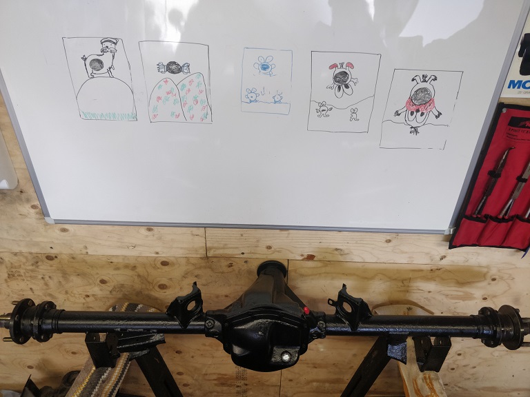

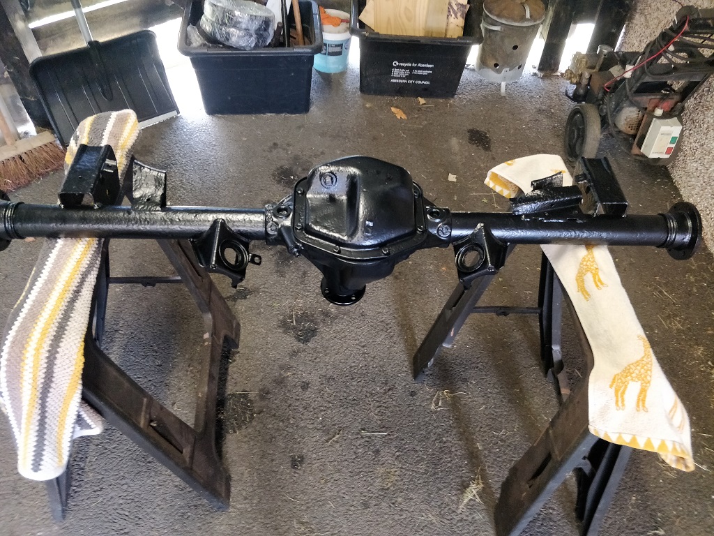

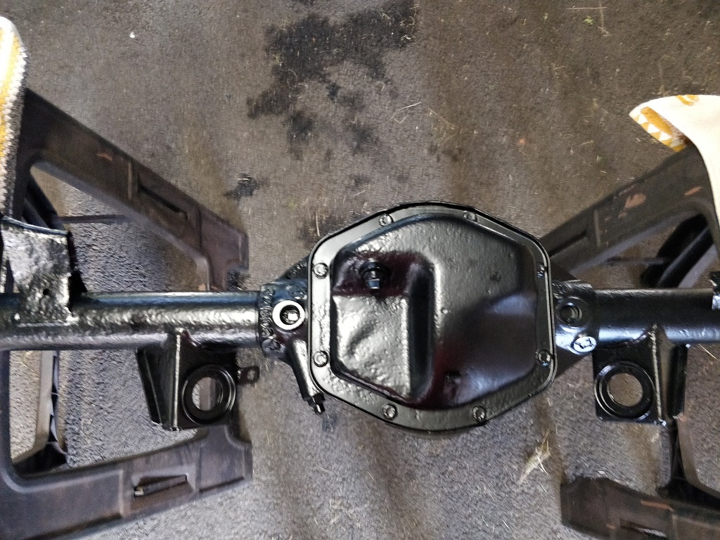

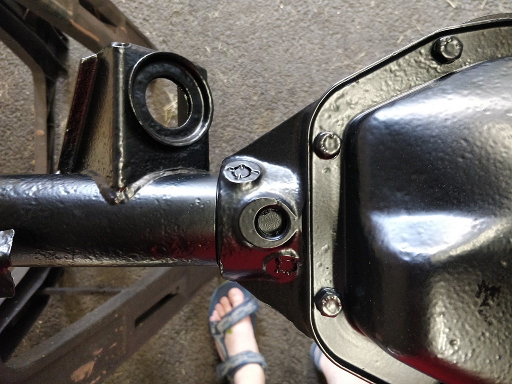

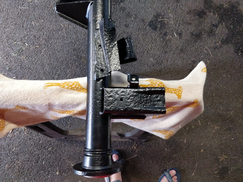

Hi
So, that's it back from the powder coating and what a difference it has made. I bought it from a farmer and it was buried in the mud so I am surprised it looks this good!
Currently replacing the pinion seal, inner and outer bearing seals and wheel bearing. Then I will fit MG studs and make up a bracket for a rear disc conversion as per my Standard 1500TC axel.
Regards
Barry

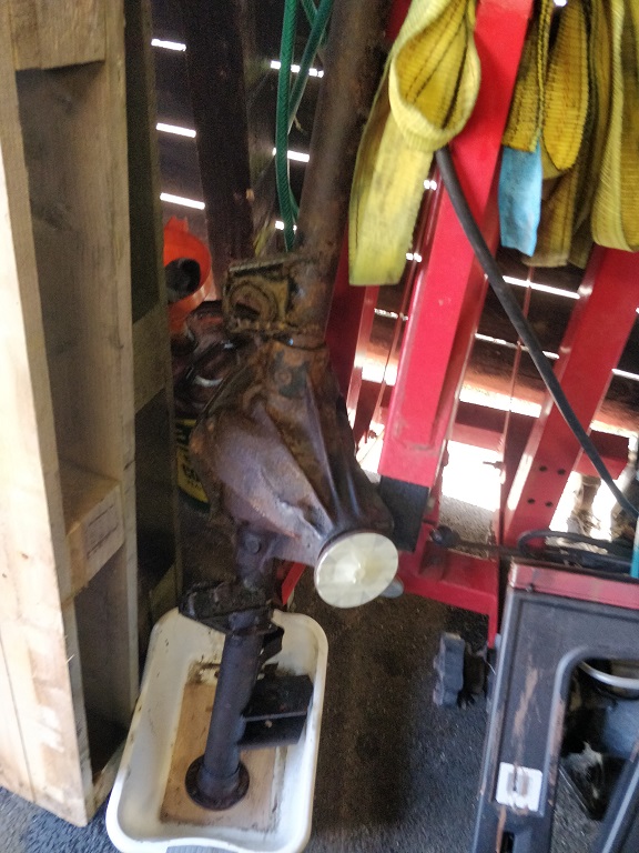

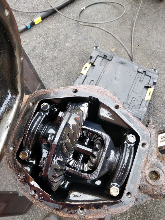

Internals look good, sadly no LSD!

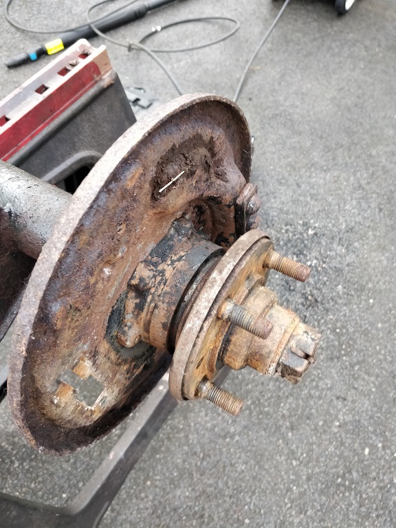

Drum removed, a bit rusty!
Srpint rear axel - Hub as found.jpg (196.66 KiB) Viewed 1196 times

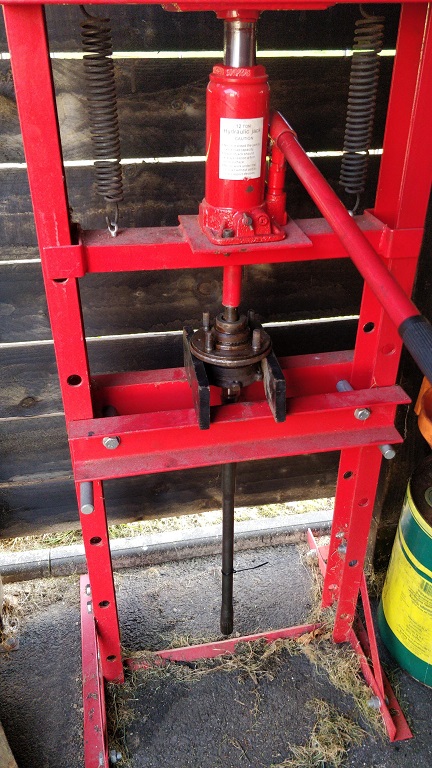

yorkshire_spam wrote: Fri May 20, 2022 10:15 am Coming along nicely!

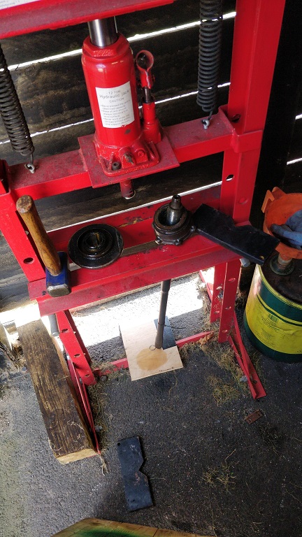

Thanks, but the hubs are a bit of a pain with my cheapo 12 ton jack struggling, hopefully the other side is easier (although nothing some fire and technical tap didn't fix)!
Regards
Barry
set
set
Sprint rear axel - Hub in press.jpeg (172.41 KiB) Viewed 1189 times
Went with a bang
Went with a bang
Sprint rear axel - Hub in press - with a bang.jpeg (161.8 KiB) Viewed 1189 times

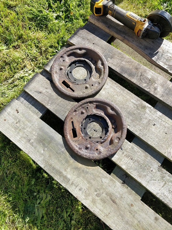

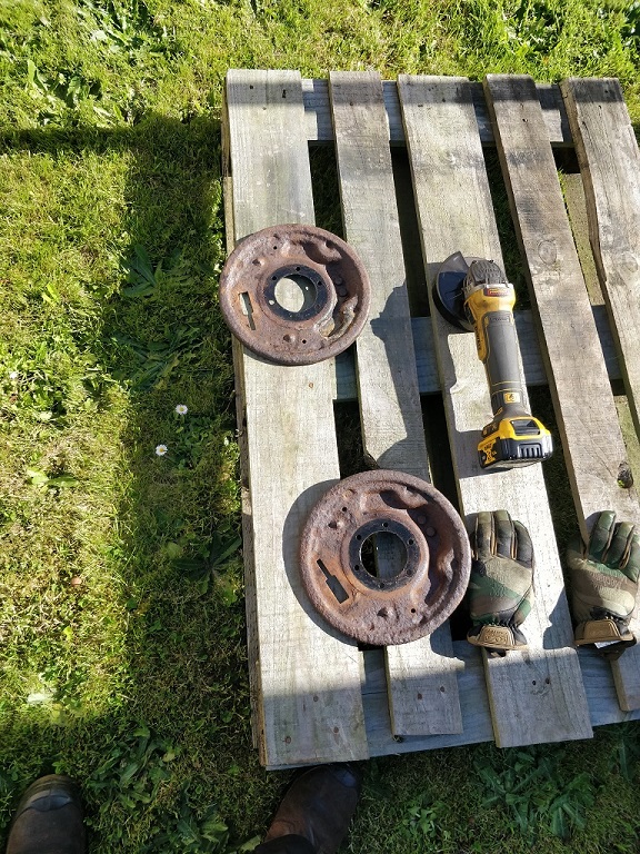

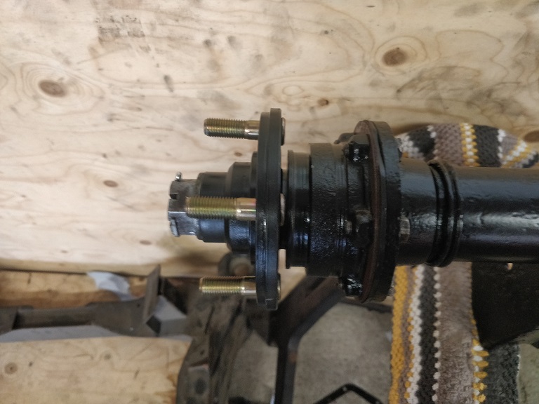

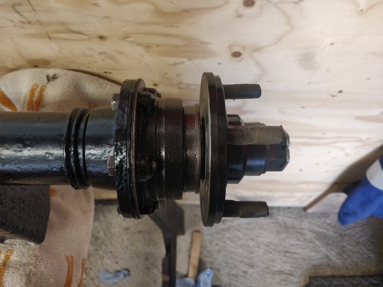

Now all rebuilt, with a sump plug and MG TF studs fitted. ( I used a plug off ebay for motorbikes with a magnet size M10 x 1.5 and although the red anodising is not really in keeping, I like it).
To keep the end float correct I cut up the old backing plats to use as spacers as I didn't have any 3mm thick steel to make one, and it was a lot easier to cut them up as I have no need for them anyway.
Also some of the eagle eye'd of you might see the grease cover (the bit that covers the back of the hub) has been removed while changing over to MG TF stubs. I cant see it causing an issue but I might replace if needed, although I wrecked one of them so hopefully not!

Drain plug
Drain plug
Sprint rear axel - Drain plug.jpg (144.16 KiB) Viewed 1066 times
passage
passage
Sprint rear axel - Complete - Passenger.jpg (121.76 KiB) Viewed 1066 times
driver
driver
Sprint rear axel - Complete - Drivers.jpg (129.18 KiB) Viewed 1066 times
complete
complete
Sprint rear axel - Complete.jpg (122 KiB) Viewed 1066 times
after
after
Sprint rear axel - Backing plates - Cut.jpg (301.97 KiB) Viewed 1066 times
Befor
Befor
Sprint rear axel - Backing plates.jpg (295.3 KiB) Viewed 1066 times
