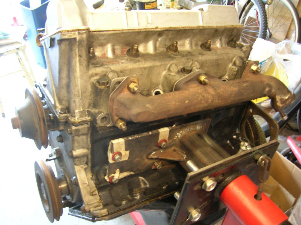

Bumpa
Posts: 691
Location: Ayrshire, Scotland
Re: Dimension of engine mounting point
#10 Post by Bumpa »
Here's mine, welded on a cheapo MIG 100 amp from Machine Mart.
Engine bracket.jpg (147.43 KiB) Viewed 711 times
cleverusername
Posts: 1560
#11 Post by cleverusername »
Bumpa wrote: Thu Jun 30, 2022 8:41 pm Here's mine, welded on a cheapo MIG 100 amp from Machine Mart.
Looking at that weld, I think your welder might be a bit underpowered for plate of that thickness. If it is holding fair enough but my, as it turns out, 140amp welder was only just up to the task of welding 5mm plate and that was with a V groove to help penetration.
Bumpa
Posts: 691
#12 Post by Bumpa »
cleverusername wrote: Fri Jul 01, 2022 8:30 pm
You are probably right. I did V-groove the plate for welding. Fortunately it held and showed no sign of letting go. I can't see it being used again. You just use the tools you possess don't you!
