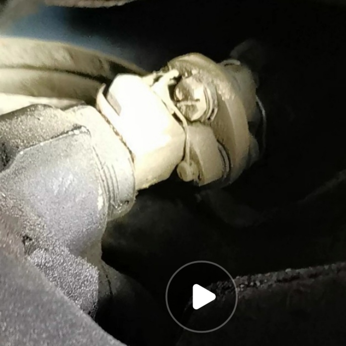

OK so I will have to measure the centre disk. Looks like the bolts are the original wire locked ones.
- Screenshot_20220621_124304.jpg (104.62 KiB) Viewed 756 times
1972 Toledo 4 door "Betty"

Yes, that will be simple to refurb with a set of new bushes.
