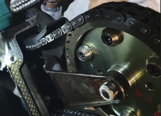

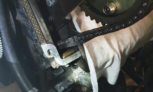

Re: TriumphTune TT10105N cam
I was looking on exhaust side. The 2 is there by the inlet port
Its annoying you can't see the degree of wear on the tensioner without taking the engine apart. The other guides look ok.
How would I place the order and pay you. I can transfer funds from UK bank.
And the early head design? No one is aware of any drawbacks?
