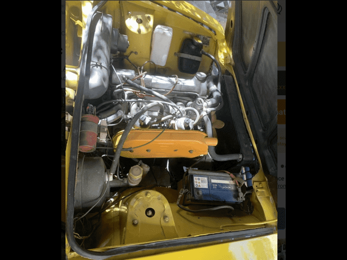

Can you post a picture of the engine bay and we can tell you if it is an 1850 engine or not, but I'd have thought sourcing Sprint running gear in Cyprus historically would not have been straight forward, though I do know the British Consulates used to hold stock of spare parts for government cars as I imported a load of new old stock doors from Cyprus many years ago...

Re: Is it or is it not a Sprint
- BE69E004-0E9E-4FC2-88C2-DF50D1CD8553.png (107.59 KiB) Viewed 12328 times

That’s an 1850 engine running early Strombergs; sorry if the news disappoints.

Unfortunately that's just a casting number, not the engine number. The engine number is stamped into the casting and some are so light as to be imperceptible.
The photograph you have shown in undoubtedly an 1850 8 valve unit.
