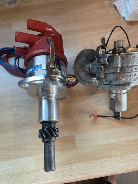

Re: sprint electronic ignition- current options
Get one made to order Clive. No adaptor.
- 9E5D1333-D242-4F8C-9CED-812921E2BD0F.jpeg (106.83 KiB) Viewed 1066 times
