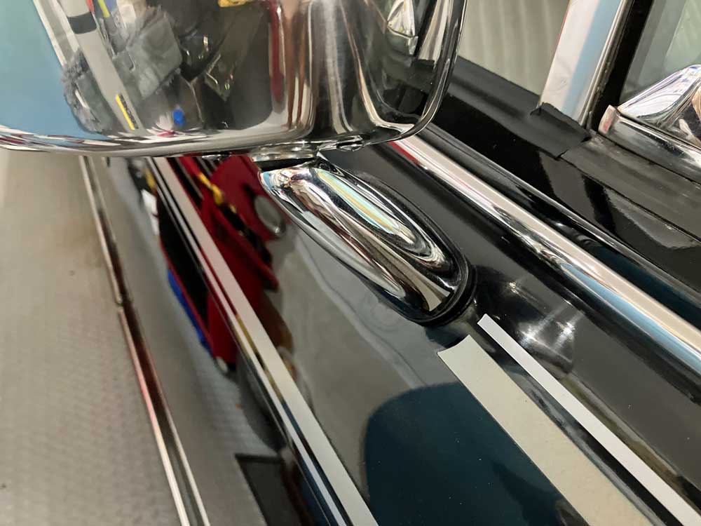

I just took mine of to take a picture of the back plate on the drivers side. I had to drill 6.5mm holes on the (offside) passenger side to fit a mirror there for overtaking...
The 'wedge' may work, if it had longer screws, but I didn't try that.

I know it makes the job a lot more complicated, but I find the "fit from outside" design of these mirrors pitiful as far as security and tightness is concerned. So I take the door cards off, shave the plastic sleeve down till flush with the inside of the doorskin and use a "spire nut" on the inside so the screw has something to tighten into that WON'T work loose over time! I also like to put a dab of sealer round the holes to stop any water getting in there.

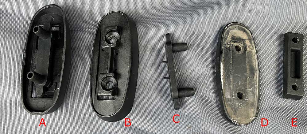

Carledo wrote: Fri Jun 30, 2023 7:11 pm I know it makes the job a lot more complicated, but I find the "fit from outside" design of these mirrors pitiful as far as security and tightness is concerned. So I take the door cards off, shave the plastic sleeve down till flush with the inside of the doorskin and use a "spire nut" on the inside so the screw has something to tighten into that WON'T work loose over time! I also like to put a dab of sealer round the holes to stop any water getting in there.
I did consider removing the door card and fitting spire nuts but I 'think' the fit from the outside is meant as a 'safety' feature so if the mirror hits something i.e. a person, it would detach from the body causing less harm. I did apply paint then some Bilt-Hamber S-50 around the holes to try and reduce the possibility of 'tin worm'
xvivalve wrote:There is no separate retaining wedge on the type Injebreck has, it is part of the integral plastic moulding; the two parts you have exposed by removing the mirror are a single part...see Injebreck's photograph
The fitting kit should come with several options, the wedge part being only 1 of them. I may have kept the other bits so will dig them out later and take a picture (out all day so may be tonight)
The picture I took of the fitting on the car is of 2 separate parts, not 1, both of which came in the fitting kit.

So lets actually try and answer Injebreck99's initial post.....
So the mount that he has should look like 'A' on the reverse which is basically B & C combined. To fit that then he may need to remove the door card as suggested by Carledo and use a spire nut on the back to get the screws to tighten to make it secure. (Longer screws may be needed) Care needs to be not to overtighten though as the wedge part may deform (it did for me)
Then when fitting the mirror on the back plate you need to push down to ensure the grub screw goes low enough down to 'bite in', overtightening may cause it to ride over as shown in the initial image.
I found the 'wedge' to soft and had the same issue with the grub screw over riding the wedge so....... I opted to use 'D & E' (E should have the rubber plugs moulded on the reverse to fit the 6.5mm holes as per 'C') and simply fit from the outside of the car without removing the door card. My mirrors are nice and stable and can be adjusted by hand with no issues.

Thats fine if you get all those different parts, which it would seem are not in all the kits. If you don`t get D & E, how can you use them.
I would return the mirrors or question the seller and a lesson for anyone else buying these mirrors off an auction site to check what you are getting before you buy.

Looking at the eBay listings nearly all show the mirrors with the full kit https://www.ebay.co.uk/sch/i.html?_from ... r&_sacat=0 but there are listings for the actual kit as well if the relevant parts are 'missing' and the OP has no joy with the seller.
However given the quality of the items supplied it's probably down to overtightening of the wedge unit to get it feeling secure which is distorting it, pulling the centre down, so the mirror grub screw sits to high to bite lower down on the wedge when you try and fit the actual mirror to the base.
